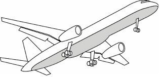

On December 20, 1995 at about 9:45 p.m. (US Eastern Standard Time), American Airlines Boeing 757 (figure 1), flight 965, from Miami, Florida to Cali, Colombia hit the west slope of a mountain at about 8,900 feet Near Cali and crashed into the West slope near the peak of the mountain. In this accident, 159 people died and 4 people were seriously injured. Among the 163 in total were 2 flight crews, 6 flight attendants and 155 passengers. |

The accident airplane, Boeing-757, was a so-called "glass cockpit" type, which was the first commercial plane with autopilot. The "glass cockpit" has CRT and LCD displays for its instrumentation instead of analog meters. This type of airplanes carries a computer called FMS, whose monitor displays navigation data, system monitors, and the flight route. FMS automatically steers the plane to the aimed route when a pilot inputs the route into the CDU from the console; it was a breakthrough airplane required only two pilots (operable from either seat) to fly. |
