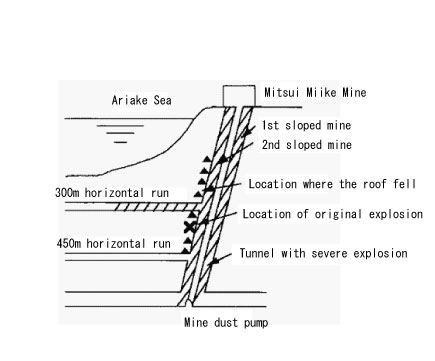

An explosion occurred in a mine tunnel at Mitsui Miike coal mine roughly 500 meters below the mine ground-level entrance. The blast and flame caused roof fall in many areas in the tunnels, which then quickly filled with carbon monoxide. 458 people were killed and 555 people were injured. It was the worst postwar mine disaster. Lack of safety provisions was the primal cause. Figure 1indicates the cross-section of the accident site. The coal beds at Mitsui Miike sloped towards Ariake Sea, and mine openings had also shifted over time towards the sea (to the left in the figure) from mountainside. At the time, coal beds roughly 350 to 450 meters below the sea level were being mined. |

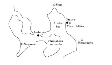

Figure1.Location of Mitsui Miike Coal Mine
Figure2.Cross section of the accident site [1]
