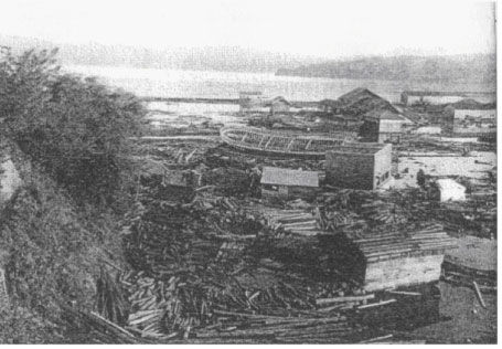

Figure 1.Devastated region: Kamaishi, Iwate

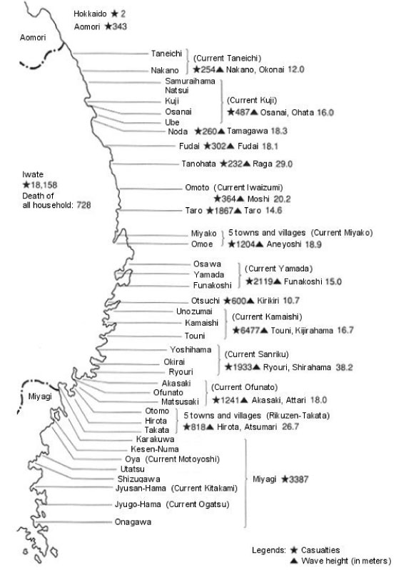

Figure 2.Local Death Tolls and Wave Heights of Meiji Sanriku Tsunami
