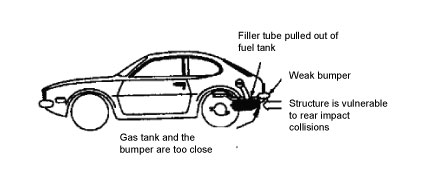

Ford rushed into the production of its newest sub-compact car, Pinto, in the much less time of 25 months versus the time it usually takes (about 43 months) and introduced Pinto to the market in 1971. In 1972, When a Pinto car stalled on a highway, another car following at 30 miles per hour rear ended the Pinto causing it to burst into flames. The driver died and the passenger was seriously burnt. As shown in Fig. 1, the fuel tank at the rear of the car was pushed forward to the deferential housing when it was hit. The fuel tank was damaged and gasoline leaked. The leaked gasoline flowed inside the cabin through gaps. The impact of the accident ignited the gasoline resulting in flames. At the jury trial of this accident, Ford's ex-employees, who were against the short development period and left the company, testified against Ford and brought significant impact on the verdict. In 1973, the US Department of Transportation proposed Federal Motor Vehicle Safety Standard 301 to Ford to improve the fuel system, but Ford filed a petition for reconsideration because of the increased costs. According to Ford's cost-benefit analysis, there is no financial benefit in complying with proposed safety standards because it would cost them $137,000,000 ($11 x 12,500,000 cars) that is 2.7 times of the estimated total compensation of $49.5 million (180 burn deaths x $200,000 per death, 180 serious burn injuries x $67,000 per injury, 2100 burned vehicles x $700 per vehicle). When this calculation was presented during the jury trial, it was considered as infringement of human rights and used as proof of malicious intention. It was used as evidence for being liable for compensation. This trial is famous for awarding more than one million dollars. (Compensatory damages of $2,800,000 and Punitive Damages of $125,000,000 [later appealed and reduced to $3,500,000]). |
a) The direct cause was design defects in fuel tank system as shown in Fig. 1. Its original design had the fuel tank above the axles, but the position of the fuel tank was moved to the back of the axle for better appearance. b) One of the indirect causes was lack of protection around the fuel tank. Due to cost benefit, weak bumpers were used. However, there were no safety measures taken to prevent deformation or to reduce impact. c) At the root of this problem, there is a contributing factor that is the policy of the company of reducing development period and taking safety issues lightly. |

Figure1.Defects in Ford Pinto 71 and 72
