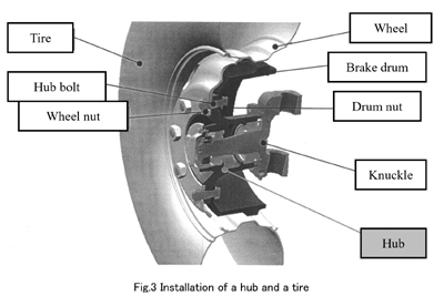

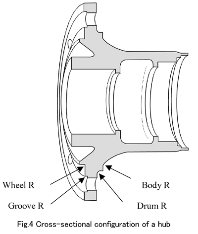

A tire came off of a heavy-duty truck and hit a housewife, Shiho Okamoto (Kamiwada Yamato-city, Kanagawa prefecture). She died soon after, and her four-year-old and one-year-old sons were slightly injured. Police in the Seya Station said the tire that had come off was the front left tire of the 26 tires on the truck. The tire came off with its wheel and fell down a slope for 50 m before it hit Ms. Okamoto on her back. She was walking on the left side of the street. The tire was 1m in diameter, 28 cm wide, and the total weight with its wheel was 140 kg. The hub is a component located between the tire and the axle that turns around the axle. The Kanagawa Prefectural Police found that the hub was broken and that the tire had come off with the brake drum. This trailer truck was purchased in 1994, and it mostly carried heavy machinery like power shovels. The trailer truck passed an automobile inspection in January 2001. However, because the hubs lie inside the tire, it is difficult to see them from the outside. An inspector said that he checks hubs by tapping around them with a hammer. Mitsubishi Motors Corp. said that they had started to sell this type of trailer truck in 1986 and that there are about 750 trailer trucks in use now. Mitsubishi Motors Corp. also said that none of the tires had come off yet and that it has never recalled a trailer truck due to defects related to tires. Figure 3 shows the positions of the hub and the tire, and Fig.4 shows the cross-sectional configuration of a hub. A hub is a cylinder with a disc-shaped head (flange). A flange is attached to the wheels with bolts. An axle is placed inside of the cylindrical part of the hub. A hub acts as a joint between an axle and a wheel. The Kanagawa Prefectural Police investigated the tire that came off of the truck and found that the hub (22kg, made by special cast iron) was torn between the cylinder part and the disk part. Inside and outside of the hub's disk part, there were corners to fit the wheel and the brake drum to the hub. This is the critical point where trailer truck's weight and applied load while the vehicle is moving reach their maximum. The crack propagated in a straight line connecting the inside and outside corners. There were eight bolts remaining on the wheel. |

Fig_3.Installation of a hub and a tire
Fig_4.Cross-sectional configuration of a hub
