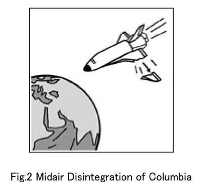

Space shuttle Columbia disintegrated in midair over Texas while it was returning to the earth after killed. (See, Fig. 1) This became the second tragedy in the 113 flights of the Space Shuttles, the first tragedy being the midair explosion of Challenger soon after the lift-off in January 1986. The Independent Accident Investigation Committee concluded that damage that had occurred to the leading edge of the left wing at the moment of lift-off was the cause of the accident |
Columbia was launched on January 16th, 2003 from Kennedy Space Center. Seven crew, led by captain Rick Husband, were on board. The crew carried out the scientific experiments that comprised their mission while on the orbit around the earth for sixteen days. The scheduled time for landing at the space center was 9:16 February 1st. However, contact with the control center at Johnson Space Center was lost about a half an hour before the designated landing time. At the same time, all data on its flight condition were not received thereafter. At around 9 am, small glittering pieces like meteors were observed from the ground, and some wreckage from the space shuttle was also recovered in Texas afterward. Then it was concluded that Columbia had disintegrated in midair. |

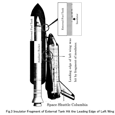

Just after lift-off, a piece of the insulator of the external fuel tank came off and hit the leading edge of the left wing of the orbiter. (See, Fig. 3) At that time, NASA made the following statement in a press interview: "There is no problem and the space shuttle will land as scheduled". Regarding the communication between the control center and the space shuttle at that time, NASA officially announced on June 30th that the flight director of Kennedy Space Center had sent following message to captain Rick Husband on January 23rd, a week after lift-off: "A block of insulator hit the leading edge of the left wing of the orbiter. However, from photographic analysis, we have concluded that there has been no harmful effect on the insulation properties of the orbiter." The captain's reply was simply "Thank you". Failure Knowledge Database / 100 Selected Cases http://shippai.jst.go.jp/en/Serach |
The Independent Accident Investigation Committee issued its final report on 26th of August, 2003. The report concluded that damage to the left wing of the orbiter at the moment of lift-off was the initial cause of the accident. The report also concluded that NASA's lack of attention for safety was another cause. As a condition for resuming the space shuttle flights, the Committee advised twenty-nine items for revision in order to prevent the recurrence of the accident. On January 16th, about eighty seconds after lift-off, a piece of the insulator of the external fuel tank came off and hit the leading edge of the left wing of the orbiter with the speed of 850 km/h. It was concluded that the orbiter disintegrated at the moment of reentry on February 1st , because air with very high temperature blew in from the damaged area. Although pieces of insulator had fallen off frequently in the past, NASA ignored many concerns raised by people about the possible damage that could occur and did not take any steps to cope with the issue. The Committee severely criticized NASA's attitude, stating that this failure to cope with the issue was one of the main factors contributing to the accident. |
