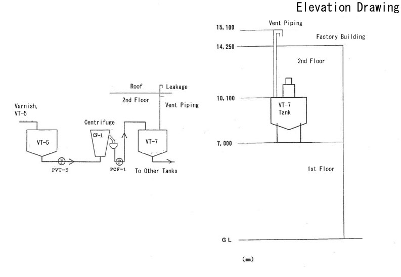

At a manufacturer of ink for newspapers, the raw material varnish for newspaper ink was refined by centrifugation and transferred to a purified varnish tank. Purified varnish leaked from the clearance of the upper manhole of the tank installed at the building's second floor. In addition, varnish spouted out from a vent pipe tip on the manufacturer's roof. The varnish that had spouted from the vent pipe passed through a rain gutter and rain water piping from the roof, and leaked into a canal. |
Transfer |
Process Flow |
Fig2.Process flow

At about 16:00 on April 27th, 1994, an alarm in the control room of tank VT-7 rang, and the alarm light indicating full occupation lit. The volume in the tank was confirmed by opening the manhole of the tank. It was judged that receiving was possible, the alarm buzzer was stopped, and receiving continued. At about 16:30, acceptance in the tank VT-7 was completed, the volume in the tank was 3850 L. The maximum control volume of the tank was usually 3800 L, and the legal capacity was 4300 L.. At about 09:30 on 28th, a varnish manufacturing operator was directed to transfer other purified varnish to tank VT-7 by the control room. The operator did not confirm the volume of VT-7 at this time. However, meantime, the control room operator who directed the transfer confirmed that the alarm lamp indicated full occupation lit. At about 10:20, transfer to tank VT-7 was started. At about 11:15, the manufacturing operator found varnish overflowing from tank VT-7. The transfer was stopped immediately. He reported to the control room. At about 11:20, it was found that the varnish had leaked from the vent pipe on the roof. |
The control room directed the transfer of varnish to the tank in spite of the alarm lamp indicating fullness of the tank lit. The manufacturing operator transferred the varnish to the tank without confirming the tank level, and varnish overflowed. |
