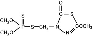

DMTP (o, o'-dimethyl-S-[5-methyl-1,3,4-thiadiazole-2(3H)only-(3)-methyl]dithiophosphate), Fig3 |
