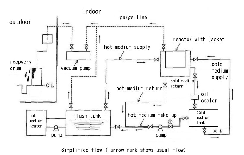

Fig2.Unit process flow

On November 30th, 1992, 08:40 Preparation of heating medium oil started for heating and cooling a reactor for varnish manufacturing. 08:45 A circulating pump and a vacuum pump operation started to remove water in heating medium oil in a flush tank. 08:50 A heater for heating medium oil was switched on. 08:55 A feed pump was switched on and supply of heating medium oil to the flush tank started. 09:00 The temperature of the flush tank reached 160 °C, but the heater was not turned off. It was to be turned off when the temperature reached 130 °C during standard operation. 0910 The vacuum pump was turned off and an air vent valve was opened. Heat medium oil leaked from the exhaust line of the vacuum pump and spilled into the drain. The oil escaped into the sea via a public sewer. Refer to Fig2 |
1. The standard of operation procedure was ignored: heating medium oil should not be supplied when a vacuum pump for a flush tank is working. Supplied oil leaked through the vacuum pump because valves were not set correctly. 2. Heating of oil for removing water should be stopped at a temperature between 130 °C and 150 °C. The standard of operating procedure was ignored and the temperature reached 160 °C. This negligence resulted in escaping of oil vapor through the vacuum pump, and it was condensed by cooling. 3. There were no facilities to prevent oil leakage to the drain at the end of the exhaust line of the vacuum pump. |
