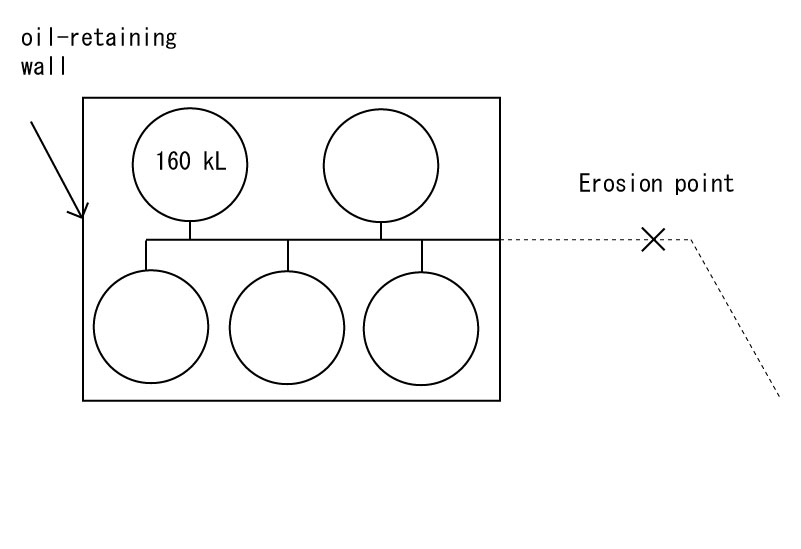

In 1991, leakage of ethanol from an opening in underground piping into the sea was noticed at a fermentation factory in Hiroshima prefecture. The leakage had continued for a long time and was noticed because the volume increased on December 2nd, 1991. The opening was generated due to corrosion in the piping, which was attached to tank facilities constructed in February, 1969. The leakage was not noticed for a long time because ethanol is water soluble. |

Ethanol leaked from a crack at underground piping of an outdoor storage tank into the sea. The leakage might have started a long time ago and was noticed because the volume increased on December 2nd, 1991. The piping was attached to tank facilities constructed 23 years before, i.e., February, 1969. |
Piping had openings due to corrosion. The leakage was not found for a long time because ethanol is water soluble. |

Fig2.Map of corrosion place
