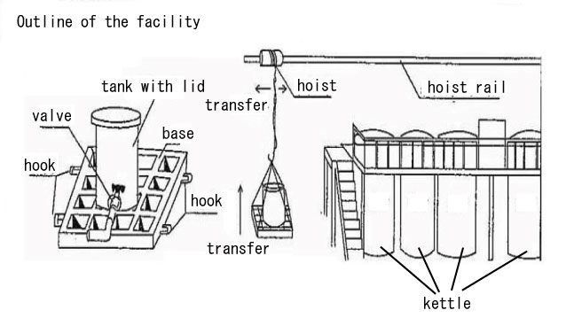

On November 28th, 1992, a container of ethanol was lifted up above a distillation drum with a hoist at a soy sauce manufacturer in Tochigi prefecture. One of the four hooks came off and the container fell onto the floor. The ethanol spilled and was ignited by an oil heater. |
A container of ethanol fell at a soy source manufacturer. The spilled ethanol was ignited by a heater and a fire started. Refer to Fig2. |

A container of ethanol was being lifted above a distillation drum using a hoist at a soy sauce manufacturer. One of four hooks came off and the container fell onto the floor. The ethanol spilled and was ignited by an oil heater. |
One of four hooks of the platform came off and ethanol container fell onto the floor. |
