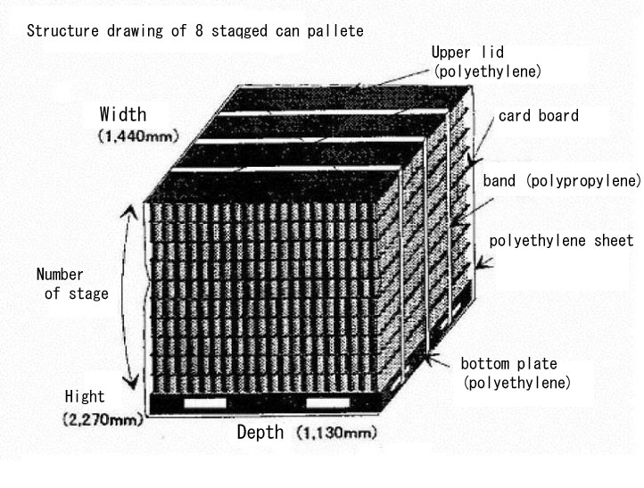

On November 8th, 1995, at a can manufacturing factory with a large-scale rack warehouse, an inflation film-packing machine (an infla-packer) failed. The infla-packer was repaired, while manufacturing of the cans and automatic conveyance to the rack warehouse were continued. While the infla-packer was being repaired, the heater of the infla-packer and a polyethylene shrink film covering a stack of steel cans on a pallet made contact with each other, and the film ignited. Automatic conveyance was underway, and the ignited pallet was positioned at the seventh stage of the rack warehouse. The fire spread to the whole warehouse. 17 hours were needed to extinguish it. Infla-packer; an automatic packing machine which stacks produced cans on a pallet, and performs shrink-packaging. |

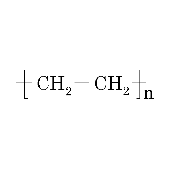

n usual operation, an infla-packer and a polyethylene film do not contact each other. However, it was proven that a heater and a polyethylene film might contact each other when various factors overlap. For instance, workers adjusted the infla-packer many times before the fire, and the condition of the infla-packer at the time of the accident was not the same as its condition at an appearance test or a field survey. The maximum temperature of the heater section of the infla-packer was over 600 °C, while the ignition temperature of polyethylene is below 340 °C. Polyethylene ignites with a contact time of three seconds or less at a contact temperature of 600 °C or more. It can be considered that the fire broke out with ignition following contact between the can pallet and the heater of the infla-packer during manufacturing of the can pallet and a transfer process to the warehouse, because nothing is considered as a heat source other than the contact. |

Fig2.Configuration of 8-stage can pallet
Fig3.Chemical formula
