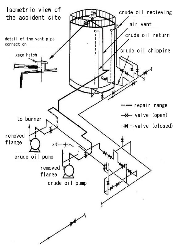

There occurred a fire and an explosion at a power plant of an electric power company. Remodeling of fuel supply piping was being carried out near a 200 kL fuel service tank for supplying fuel to the power generator boiler. Air vent piping of the fuel feed pump ignited during cutting. The fire spread and the tank exploded. As there was no valve in the piping to the tank, combustible vapor in the tank vapor phase moved into the piping. |
A fire and an explosion occurred during repair work for fuel piping in the power station of an electric power company. The accident occurred on cutting air vent piping leading to a fuel service tank from a fuel feed pump. Flames were propagated in the piping, an explosion occurred in the service tank, and a fire in the tank and in the oil retaining wall occurred. As the power station was close to the city center, there was extensive smoke damage. Refer to Fig2. |

1. Use of a power generation unit including the burning tank was stopped for a turnaround shutdown in early April. 2. In the tank, there was a large amount of mixed oil of remained crude oil and gas oil, which was used for cleaning after stopping the tank. 3. Welding started to change air vent piping at discharge of a fuel feed pump as a part of rearrangement of fuel oil piping to the power generator boiler. 4. The tank exploded suddenly. |
1. The air vent piping to be welded was connected to the tank without any valve in the connecting piping. 2. Part of the light component of crude and gas oil in the tank evaporated, evaporated gas went into the air vent piping from the upper part of the tank, and a flammable atmosphere was formed. 3. It is assumed the gas was ignited by a welding flame, the fire spread through the air vent piping, and the gas exploded when the flames reached the tank. |

A 200 kL cone roof-type tank containing 164.08 kL of an oil blend of crude oil and gas oil exploded. The roof was blown about 15 m away and the main body collapsed. The blend oil leaked into the oil retaining wall and burned. About 100 kL was lost by the fire. |
Fig2.Isometric view of the accident site
