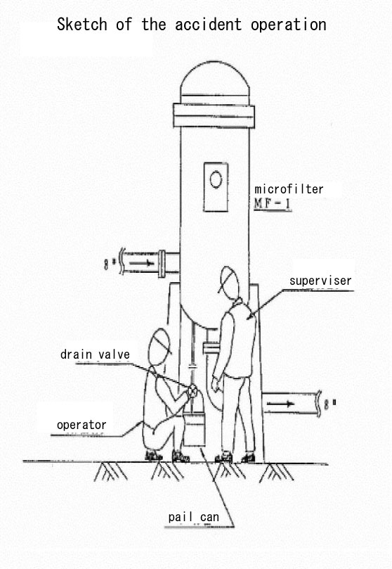

A mistake during drain work for a filter at a tank lorry station of a refinery caused 500 L of gasoline to leak, and a fire occurred. Hanging a pail with a plastic handle on the drain valve generated an insulated condition. As the drain work was done at a bigger valve opening than usual, drain was ignited by a spark discharge of static electricity, and the fire spread. Since the fire occurred near the drain valve and the valve could not be closed, the leakage became a lot of quantity. |
Drain work for a gasoline shipping filter was carried out at a tank lorry station in a refinery. When the valve was opened, gasoline flowed from the drain nozzle by mistake. It ignited in the receiver. The valve could not be closed because the leaking gasoline was burning around the drain valve. 500 L of gasoline leaked, and the fire spread. Refer to Fig2. |

1. Two operators carried out drain work at a shipping filter which was to be conducted once a week. 2. One operator hooked the handle of a pail (receiver) onto the drain valve, and they started draining. 3. The valve was thought to be clogged because the flow of drain became smaller during work. The valve was once closed. Then it was opened with a 1/2 rotation not the usual 1/4 rotation. Gasoline flowed out rapidly accompanied by a mist. 4. A fire broke out almost simultaneously in the pail when the gasoline flowed out. Workers tried to carry the bucket outside. 5. They tried to close the valve to stop the gasoline leakage. However, they could not close the valve because of the burning gasoline. |
1. The handle of the pail was made of plastic, and the pail was hung with this handle. Therefore, the pail was insulated and there was a strong possibility of static electricity being charged during the drain work. 2. Gasoline with a mist flowed out and ignited when the valve was opened by a 1/2 rotation. It is speculated that a lot of static electricity was generated in the mist. 3. The cause is considered to be ignition by electrostatic discharge. The slightly clogged valve led to the bigger valve opening and a flow of mist. However, draining operation itself is a countermeasure for the accumulation of a slight volume of water accompanied with gasoline. Besides, the valve material was steel. It is natural to have slight clogging of a valve. |

Fig2.Sketch of the accident operation
