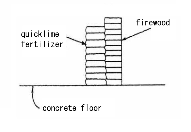

Quicklime was stored directly on a concrete floor. Firewood was stacked in the same cattle barn next to the quicklime. The firewood made contact with the quicklime at a damaged part of the quicklime package, and it reacted with moisture or leaked rain falling from the previous day. It might generate heat. A fire broke out from the firewood, burned down the cattle barn. Besides, the facilities were unlicensing under the Fire Protection Law. |
A warehouse was partly used as a cattle barn. Quicklime (the 20 kg × 70 bags) purchased for meadow soil improvement and ammonium sulfate fertilizer (110 bags) were stored in the warehouse. The bags were piled up directly on the concrete floor. Next to the quicklime, firewood was stacked to chest height. It ignited, and the warehouse and barn burned down. |

The following two possibilities were considered. 1) The packaging material of the quicklime was damaged when it was carried into the warehouse for storage in the warehouse. It contacted the firewood, reacted to the moisture in the firewood, and generated heat. 2) Rainfall on the previous day leaked through the roof, reacted with the quicklime, generated heat, and ignited. Reaction formula for an exothermic reaction is shown in Fig3. |
If quicklime is put on a floor directly, it easily comes into contact with water and it is dangerous. A pallet should be laid and the quicklime should be put on it. Protection against rain water should be provided. It is important to make the structure with a sufficient heat release system. |

Fig2.Sketch of quicklime storage
