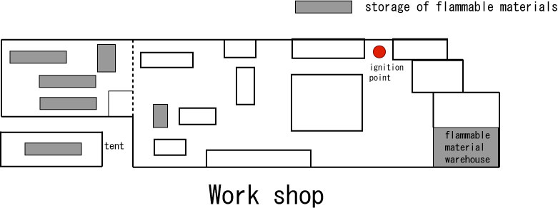

A fire occurred 5 hours after work ended and there was nobody in the workplace. Refer to Fig2. |

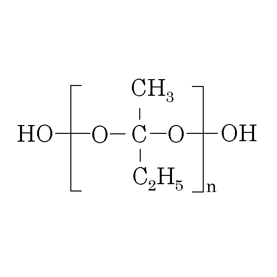

Methyl ethyl ketone peroxide, Fig3 |

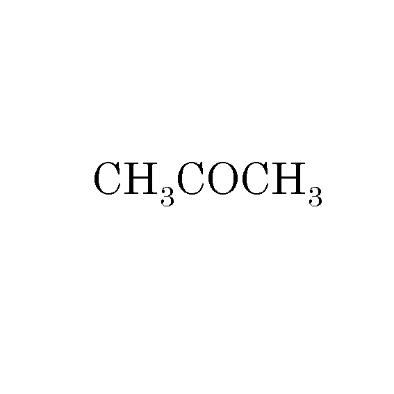

| Acetone, Fig4 |

All employees left without locking the workplace after their work finished. A fire occurred five hours later because of dangerous materials in the workplace. Methyl ethyl ketone peroxide (MEKPO), which is organic peroxide, and other dangerous materials were stored without permission. |

Because of ignorance of the hazard of dangerous materials, many kinds of dangerous materials (under the Fire Protection Law) were stored and handled without permission and workers left the workplace without locking up. After the fire, it was found that a large amount of MEKPO, acetone, and many petroleum fractions were stored. |

Fig2.Schematic diagram
Fig3.Chemical formula
Fig4.Chemical formula
