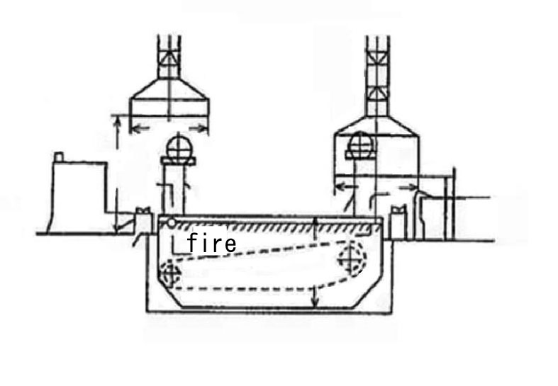

At a quench hardening factory for springs, abnormally high flame was generated when a heated coiled spring for an automobile was charged into the quenching oil bath by a conveyor. The flames were extinguished using a fire extinguisher. However, the flame damaged electrical wiring of the conveyor, nearly caused a short circuit, but operation restarted without sufficient checks of the facilities and the damage was overlooked. In the first batch of re-operation, the spring stopped before being immersed in the oil 8 cm above the surface due to a short circuit in the conveyor. Quenching oil was heated by the high temperature of the coiled spring, and vapor was generated. The vapor from the quenching oil ignited, and a fire occurred. |
At quench hardening facilities for springs, when a heated coiled spring for an automobile was supplied into a quenching oil bath by a conveyor, the abnormally high flame was generated, and was extinguished using a fire extinguisher. In normal operation, flames extend about 1 m and die down when the spring is completely immersed. The flames were not automatically extinguished this time. Then next batch started as usual without any effort to find the effect of the large flame. Before the coiled spring was completely immersed in the bath, the conveyor stopped by a short circuit. The surface of the quenching oil was heated by the high temperature of the spring, vapor from the quenching oil ignited, and a fire occurred. Refer to Fig2. |

Fig2.Introduction to hardening system figure
