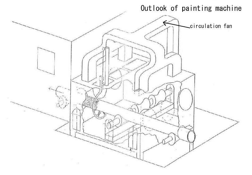

A fire broke out inside the painting machine on a steel pipe painting line of a steel mill. The painting material was phenolic resin including linseed oil, and a large amount of its leavings accumulated in the machine, and adhered to the filter of the local exhauster. Refer to Fig2. |

Fig2.Outlook of painting equipment
