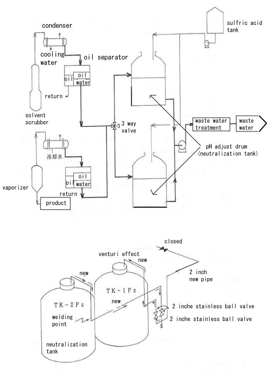

The coagulating sedimentation tank was installed in the waste water treatment facilities. Neutralization and aeration were carried out with injecting a small amount of sulfuric acid, while waste water was circulating. Hot work to install waste water return piping started while operation of the tank continued. The explosion occurred soon after welding for temporary tacking was carried out in the tank. C5 fractions, which existed in small quantity in the waste water due to aeration evaporated, and became a combustible gas-air mixture. It was ignited by welding sparks. |
The waste water treatment facilities were being operated for the first time after the coagulating sedimentation tank had been added. As hot work to install the tank still continued, flammable gas generated during the operation ignited by welding sparks and exploded. |

Fig2.Unit process flow

Between October 25th and 31st, 1983, a coagulating sedimentation tank was installed in waste water treatment facilities. 10:30, on November 2nd; neutralization and aeration started with injecting a small amount of sulfuric acid, while waste water was circulated in the neutralization tank. 13:00: work to install a return line of waste water from the tank started while operation of the tank continued. 16:23; an explosion occurred soon after welding for temporary tacking was carried out in the tank. |
As a result of aeration, C5 fractions which existed in small quantity in waste water evaporated, and became a combustible gas mixture. It was ignited by welding sparks and exploded. |
1. Hot work must not be allowed during operation. The safety checks before work are obligatory. 2. The facilities and operation were modified to control the generation of combustible gas. 3. Measures such as introducing the nitrogen gas blanket system into the neutralization tank are carried out to control the evaporation or vaporization of combustible gas. |
It is important to recognize the danger of carrying out operation and maintenance at one time. The fact that waste water and its treatment are dangerous should be recognized. |
Ignorance of the danger of waste water processed by an oil separator was the main factor of the accident. It is important to recognize that waste water is a hazardous material because it dissolves materials that have contacted in the process. The biggest problem is that hot work restarted while the waste water treatment facilities of the C5 hydrocarbon resin System was in operation. |
There was a mistaken belief that treating waste water processed by an oil separator has no danger of fire. |
