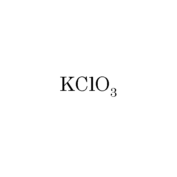

Potassium chlorate, Fig2 |

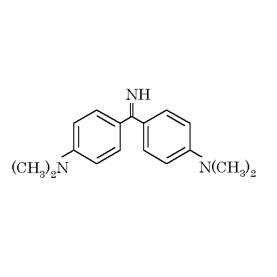

Auramine, Fig3 |

It is assumed that a mixture of potassium chlorate and a basic dye of auramine ignited spontaneously by absorbing moisture. |
1. Potassium chlorate is changed to potassium perchlorate. A basic dye of auramine should not be used. 2. Measures are taken to prevent moisture absorption of products and half-finished goods. |
1. It is forbidden to use excessively hazardous materials. 2. The storage management of the materials with the hazard of spontaneous ignition .requires carefulness. |
1. Potassium chlorate which is an oxidizing agent with high risk of ignition was used. A study on the ignition hazard was insufficient. 2. Management of storage of products and half-finished goods was inappropriate. |
