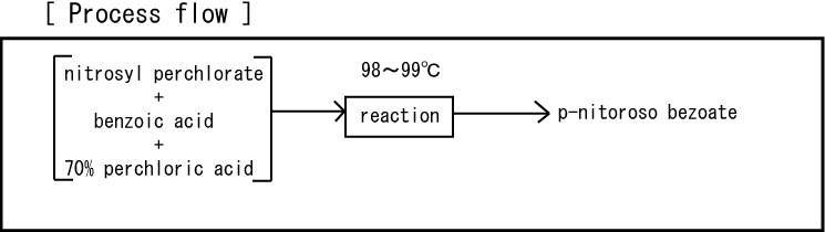

Process Flow |
Fig3.Unit process flow

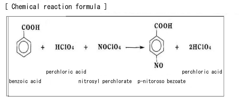

Chemical Reaction |
Nitrosation |
Chemical Equation |
Fig2.Chemical reaction formula

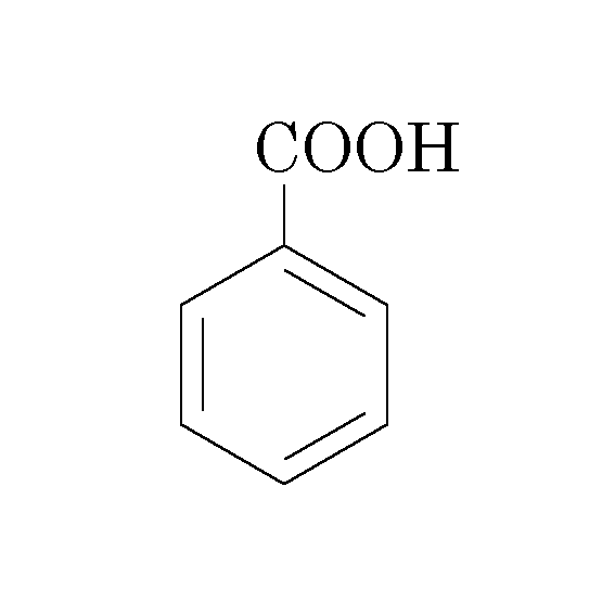

Benzoic acid, Fig4 |

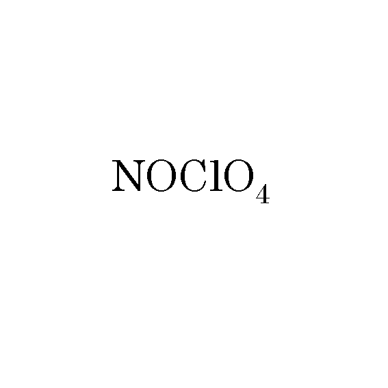

Nitrosyl perchlorate, Fig5 |

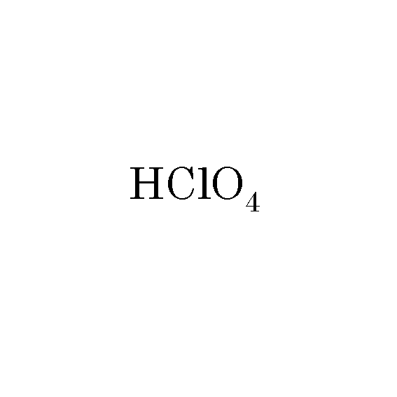

Perchloric acid, Fig6 |

4.1g of benzoic acid, 3.8g of perchloric nitrosyl, and 15g of 70% perchloric acid aqueous solution were mixed. An explosion occurred while temperature rose up to 98-99 °C with stirring. |
An explosion occurred because the temperature was raised too high for improving the yield. A sufficient yield was not obtained when it was raised up to 90 °C in the last experiment, so the next experiment was conducted at higher temperature to raise the yield. It had been confirmed that the reagent used for the experiment was comparatively stable below 100 °C, in case existing separately. However, it was not confirmed beforehand that the mixture decomposed exothermally at about 100 °C and generated carbon dioxide. |
