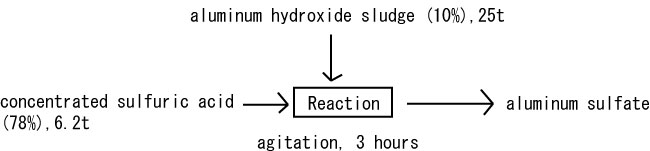

| Process Flow |
Fig3.Unit process flow

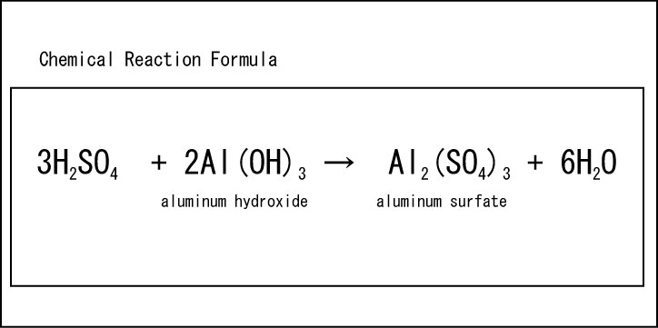

| Chemical Equation |
Fig2.Chemical reaction formula

About 25 tons of hydroxide aluminum sludge had been charging into the reactor where concentrated sulfuric acid had been charged, spending three hours. When about six tons sludge was charged, operators stopped the agitator, and took a break. The high-temperature reaction liquid spouted out from reactor after one and a half hours. |
The aluminum sulfate formation reaction is an exothermic reaction. Simultaneously, heat of dilution of sulfuric acid due to generated water is added. A high-temperature spot is locally generated in the reactor because the agitator stopped. Pressure of the part in the reactor rose and the contents spouted out. |
