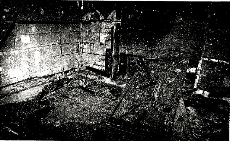

The explosion accident occurred at a fireworks manufacturing factory on June 16th, 1992. A large amount of explosives kept in the general warehouse and the raw materials warehouse exploded. It became a major disaster with three people killed, 58 injured, 15 factory buildings burned, and 631 private houses damaged. The cause of ignition has not been determined. The following possibilities have been indicated. Explosives in the warehouses, which were not explosives magazines, were ignited by impact or friction on opening or closing the shutter of the warehouse or ignition occurred by temperature rise from reaction heat or static electricity. |
The explosion occurred at a fireworks manufacturing factory. It was a catastrophe with three people killed, 58 injured, 15 factory buildings burned, 631 private houses damaged, 18 vehicles burned, 20 vehicles partially damaged, etc. Moreover, 15 craters were generated in the factory site. |

The area of about 2 km radius around the factory was damaged. Fifteen factory buildings burned. Facilities of two drying fields collapsed. 16 private houses near the factory burned. 7 buildings collapsed. 50 buildings partially collapsed. A total of 558 buildings were partially destroyed, including window glass damage. 18 vehicles burned out and 20 were partially damaged. The telephone cable was damaged by fire. |

Fig2.Photograph of fireworks and powder magazine
