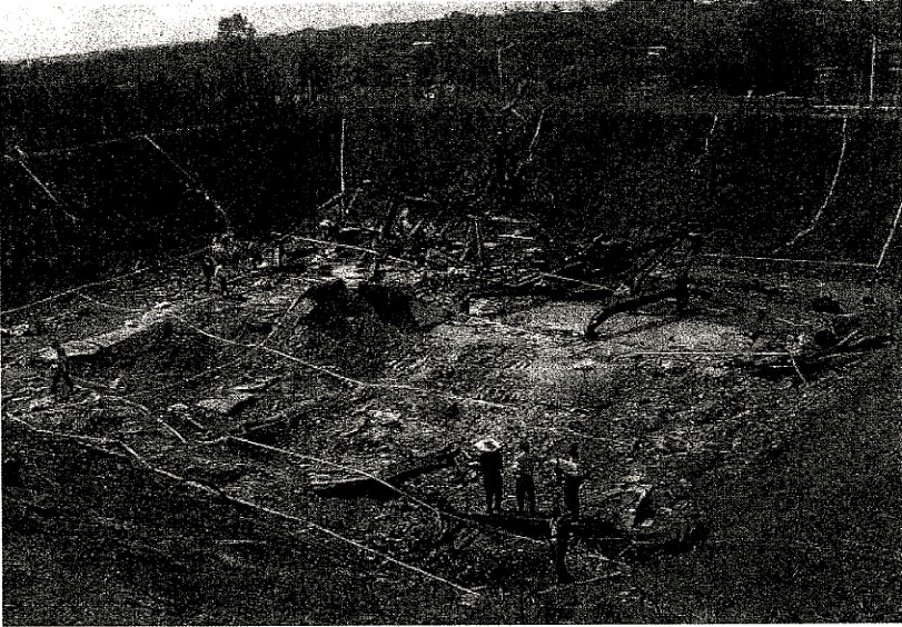

Large explosion occurred in a temporary storage of an explosives manufacturing factory on August 1st, 2000. Some smokeless gunpowder that had been kept for a long period was put on the west side of the storage exposed to the sunlight. Moreover, smokeless gunpowder had deteriorated because the control of temperature and humidity was improper, and they ignited spontaneously. The fire spread to other gunpowder in the storage, and smokeless gunpowder exposed to high temperature exploded. The storage blew without any trace and 13 craters were generated on the floor. A total of 320 factory buildings were damaged. The breakdown is 29 destroyed, 39 partially destroyed, 192 damaged, and 60 suffered glass damage. A total of 79 persons were injured outside the factory, and 888 nearby buildings were damaged. Breakdown is 12 collapsed, 26 partially collapsed, 440 damaged, glass damage to 364 buildings, and other damage to 46 houses. In addition, debris was scattered over farms in the area, with extensive damage to nearby inhabitants. |
A large explosion occurred in a temporary storage for explosives in an explosives manufacturing factory. Stored smokeless gunpowder ignited spontaneously and propagated to other gunpowder kept in the temporary explosives storage. There was a large explosion. The temporary explosives storage blew up with nothing remaining, and many factory buildings were seriously damaged. Many private houses around the factory were also damaged, and a lot of debris dispersed over surrounding farms, with major damage sustained by nearby inhabitants. The injured were all third parties. |

On August 1st, 2000, about 7.1 tons of smokeless gunpowder and about 0.6 tons of explosives, of which the principal ingredient was perchlorate, were being kept in a temporary storage. Most employees were not present because it was a holiday. On July 31st, 15:00, 36 kg of smokeless gunpowder was carried out from the storage, and 31 kg of other smokeless gunpowder was carried into the storage. At this time, abnormal phenomena related to the smokeless gunpowder such as malodor were not recognized. On August 1st, 22:09:10: The alarm of the storage operated. It was presumed that a door or a window of the storage opened. 22:09:23: The alarm was cancelled. It was presumed an event such as a cut of a transmission cable occurred. 22:09:29. Alarms operated in workrooms near the storage. It was presumed that something that affected windows and doors of these workrooms occurred. After 22:09:30. Alarms of other workrooms in the vicinity operated. It was presumed that a large explosion occurred at this time. The storage was completely destroyed. The deformed iron frame remained, the roof and the wall were scattered. Moreover, 13 craters had been generated in the floor. A total of 79 persons were injured, and they were not related to the factory. A total of 888 buildings suffered damage among nearby houses, etc. The breakdown was 12 destroyed, 26 partially destroyed, 440 damaged, 364 house with glass damage, and 46 cases of other damage. |
It is estimated that smokeless gunpowder, which had deteriorated, ignited spontaneously because it was left in a temporary storage for several years. Some gunpowder that had been kept for a long period was exposed to sunlight streaming in from the west side of the temporary storage. In addition, they deteriorated because the control of temperature and humidity was improper, and they ignited spontaneously. This fire spread to other gunpowder in the storage, and smokeless gunpowder exposed to high temperatures exploded. |

Fig2.Photograph of the accident site
