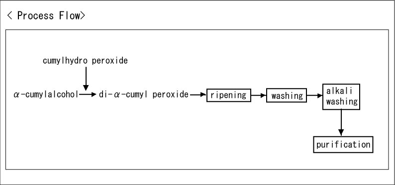

Reaction |
| Process Flow |
Fig2.Process flow
Fig3.Unit process flow

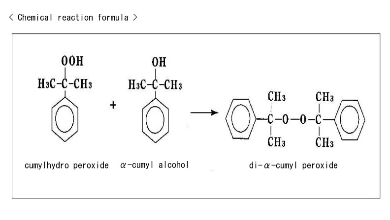

| Chemical Reaction |
Condensation |
| Chemical Equation |
Fig4.Chemical reaction formula

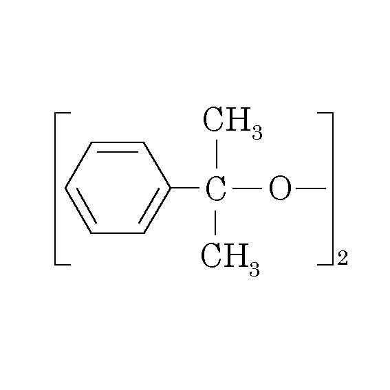

di-alpha-cumyl peroxide, Fig5 |

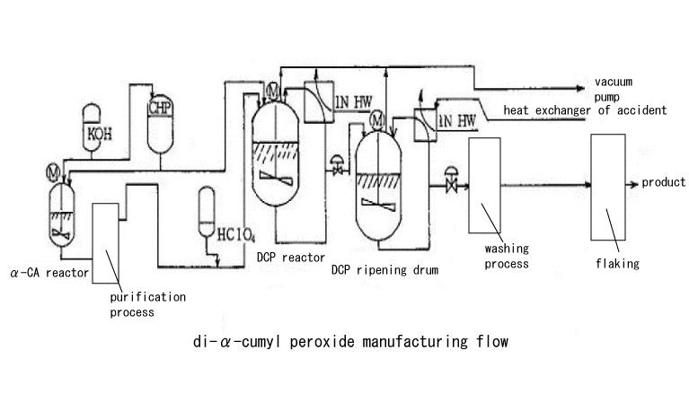

At a DCP manufacturing plant, a stabilizer for a raw material of CHP was changed from sodium hydroxide to potassium hydroxide, and a reaction catalyst of α-CA was also changed to potassium hydroxide about one month before the accident. The flow meter of a circulation pipeline between the ripening drum and external heat exchanger showed an abnormal flow rate which seemed to be due to a blockage for a week before the accident. On the day of the accident, the DCP manufacturing plant operated as usual. An alarm indicating an abnormality in the flow meter of the circulation pipeline of the external heat exchanger and ripening drum sounded in the control room. Therefore, an operator went to the site. Immediately, the heat exchanger exploded, and the contents that spouted out from piping, etc. ignited. The operator received burns and about 100 square meters of the plant, including drums, pumps, and instruments were destroyed by the fire. |
Potassium hydroxide was used as a stabilizer for a raw material of CHP and as a reaction catalyst for another raw material of α-CA. It was changed from sodium hydroxide about a month before to obtain a higher quality product. In the DCP reaction process, since perchloric acid (HClO4) is used as a catalyst, a neutralization reaction with potassium hydroxide was caused, generated potassium perchlorate (KClO4), which was difficult to dissolve in water. More potassium perchlorate deposited in the non-aqueous ripening drum than in the reaction vessel, and stuck to the wall surface of the heat exchanger. Potassium perchlorate also formed a complex with perchloric acid, and the perchloric acid was concentrated. Through the mixing of potassium perchlorate, concentrated perchloric acid, and an intermediate product of DCP, etc., an explosive mixture was generated, and it decomposed exothermally at a low temperature (42 °C), causing the accident. |
It is necessary to confirm the safety of a secondary reaction product in the development of new products. Even though the abnormality of the flow meter mounted at the outlet of the heat exchanger was detected a week before, a fundamental countermeasure with an investigation of the cause of the blockage was not taken. As an emergency countermeasure, open and close operation of the flow control valve and changing of the solution sending pump were executed, and the explosion occurred during the operation. From this fact it can be understood that an investigation of the fundamental cause of the trouble is necessary. The catalyst should be changed to sodium hydroxide, with making the process in which potassium hydroxide does not mix with raw materials. Inspections were established, and an overhaul of the heat exchanger was facilitated. The cleaning line, by which hot-water cleaning could be simplified to clean the heat exchanger inside, was installed for the prevention of a blockage. The recorder and alarm for heat exchanger outlet temperature were installed. |

Fig5.Chemical formula
