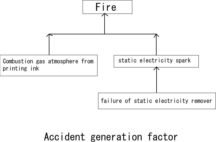

On October 11th, 1989. A fire started from the second color ink pan of a photogravure multiple rotary press. Printing started neglecting deterioration of the self-discharge style static elimination device, and it was considered that printing ink was ignited by a spark of static electricity. |

About 09:55 on October 11th, 1989. Printing started with a photogravure rotary press machine. 10:28. A fire started at the second color ink pan. 11:05. The fire was confirmed to have been extinguished. |
A self-discharge style static elimination device was deteriorated. Therefore, it was considered that combustible vapor from printing ink was ignited by a spark of static electricity. Refer to Fig2. |

A major factor was that it was forgotten or not understood that an ink solvent is light hydrocarbon and a flammable dangerous material: toluene. Also, the main cause of the accident must be a management problem, as the press machine was operated even when the static elimination device was deteriorated. |

Fig2.Accident-generation factor figure
