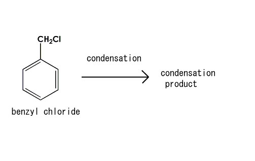

| Chemical Equation |
Fig2.Chemical reaction formula
Benzyl chloride, Fig3 |

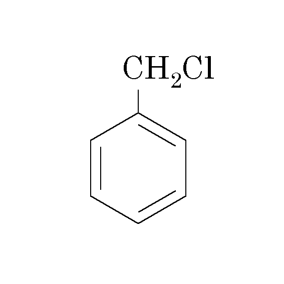

Fig3.Chemical formula
