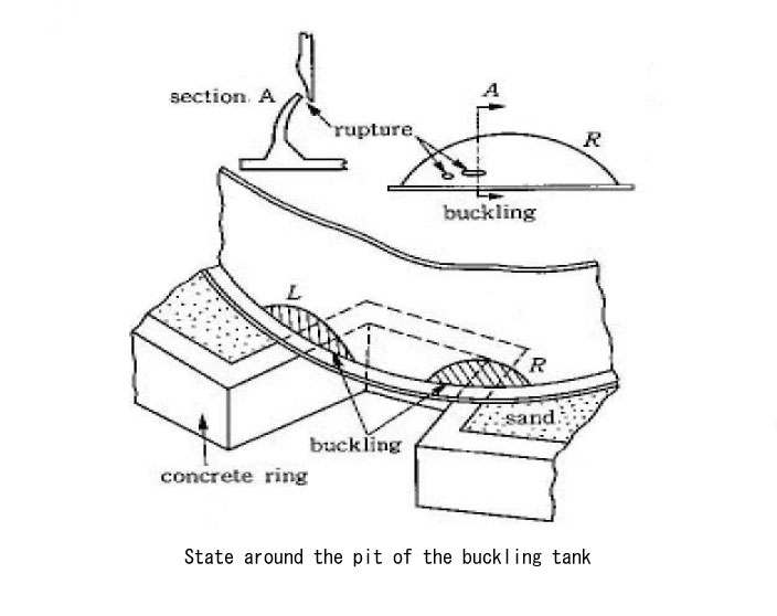

As the side wall of the tank near a drain nozzle was locally supported by concrete in the pit for drain nozzles, stress concentrated at the lower part of the side wall. 20 years or more had passed since installation of the tank, and the thickness of the side wall had decreased from 4.5 mm to 0.6-2.0 mm due to external corrosion. Refer to Fig2. |

Buckling of the side wall of a tank. About 11.5 kL fuel oil leaked. |
Fig2.Skletch of buckling tank
