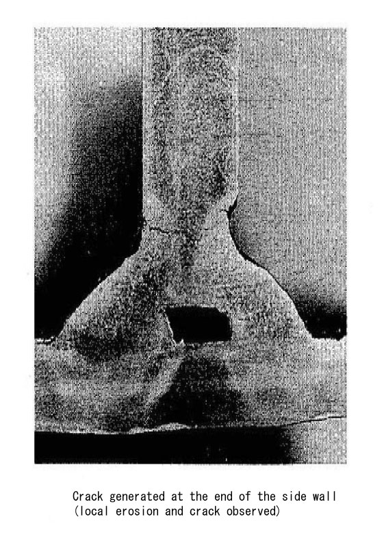

On May 28th, 1983. The "Mid Japan Sea Earthquake" caused a crack in the side wall at a lower part of a gas oil tank, and gas oil oozed out. The crack was generated where stress concentrated, and it had corroded in the shape of a slot along a weld line. |
A crack was generated near drain piping of the side wall of a gas oil tank by "Mid Japan Sea Earthquake" of magnitude 7.7, and gas oil oozed out. Refer to Fig2. |

On May 28th, 1983. A crack was generated in the side wall of a gas oil tank by an earthquake, and gas oil oozed out. |
At the drain pit, an excessive load was applied to a joint at the bottom and a side wall. It had corroded in the shape of a slot along the weld line. |
Conducting a periodic check of wall thickness using a measuring device. Check a tank with a similar structure equipped with a concrete drain pit for SCC. |
Although a natural disaster was the cause, faults in facilities can induce an accident. Daily management is very important. |
A faulty design produced stress concentration. Moreover, corrosion was left untreated. The earthquake triggered the accident. |

Fig2.Photograph of crack generated at lower part of side wall
