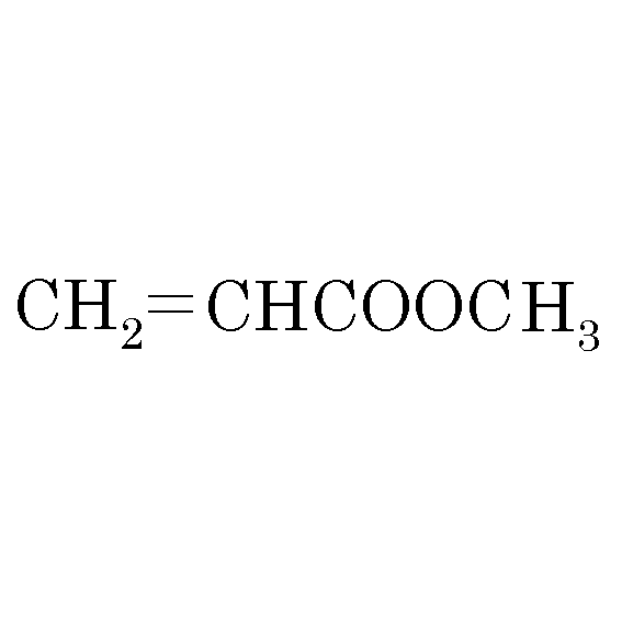

Methylacrylate, Fig2 |

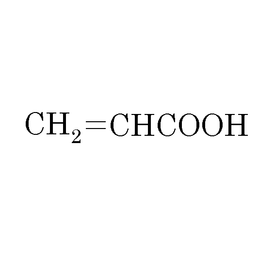

| Acrylic acid, Fig3 |

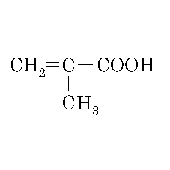

| Methacrylic acid, Fig4 |

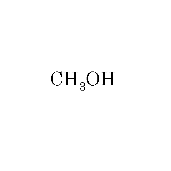

| Methanol, Fig5 |

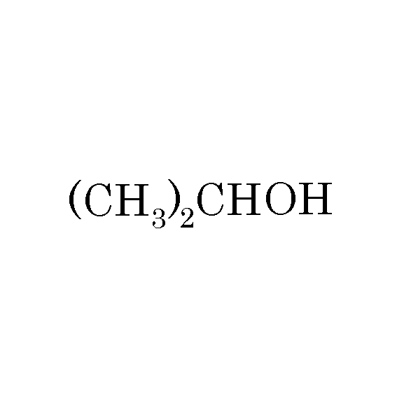

| Isopropanol, Fig6 |

Fig2.Chemical formula
Fig3.Chemical formula
Fig4.Chemical formula
Fig5.Chemical formula
Fig6.Chemical formula
