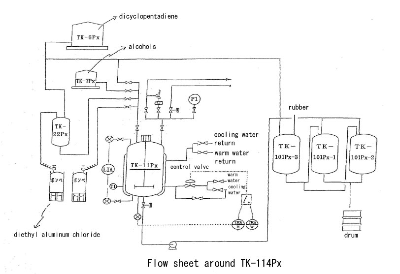

Fig2.Unit process flow

Explosion, fire |
About 16:00 on April 25th, 1996; raw materials were charged into a catalyst preparation drum, and a raw material liquid was blended. It was scheduled to be used on April 30th. Temperature in the storage tank was controlled by a computer. 12:50 on April 26th; a temperature alarm of the bending liquid A tank was activated. The normal control temperature was 55 °C, and H alarm sounded at 60 °C. After confirming the temperature, the alarm was turned off by a board operation. 13:09 on April 26th; at 65 °C, HH alarm sounded. After confirming the temperature, the alarm was turned off. 20:47 on April 26th; tank temperature dropped to 63 °C. In addition, the temperature continued to fall to below 60 °C. 12:02 on April 27th; it reached 60 °C again, and H alarm sounded. After confirming the temperature, the alarm was turned off. 12:21 on April 27th; it reached 65 °C, and HH alarm sounded. After confirming the temperature, the alarm was turned off. 02:07 on April 29th; IOP alarm sounded at tank temperature of over 105 °C. The indication of the field thermometer was confirmed. 02:12 on April 29th; efforts were made to lower tank temperature, but the temperature did not drop, so operators decided to monitor the course. At about 02:30, one operator took a short nap. The temperature did not drop afterwards. 03:32 on April 29th; the tank exploded when the other operator was patrolling the site. He was injured. H alarm; A high alarm. An abnormal sign when a measured value was higher than a set value. HH alarm: An alarm in a critical phase, exceeding H alarm. It was often connected directly to an interlock in the plant. Recently, HHH alarm was linked to starting an interlock. |
An accident occurred during storage of raw material blending liquids of the fourth blending after the method change. Under the new method, fresh raw material was charged into the preparation drum with a liquid remaining from the preceding batch. Under the old method, remaining liquid was not used. The following facts were proven by research after the accident; "Cationic species are generated in the reaction between remaining liquid and newly charged raw material. By repeating the new method, cationic polymerization by cationic species occurs, and the temperature of the catalyst solution rises. High temperature makes the reaction advance, and the solution's temperature rises rapidly. The volume of blending liquid increases because the solution temperature rises." In short, it was overlooked that an unusual reaction occurs frequently with a new preparation method. Therefore, temperature control by the computer was not effective because control was designed only for normal situations. In addition, as they could not take the appropriate countermeasures against the temperature rise, a runaway reaction occurred, the temperature reached over 100 °C, and contents spouted out. |
