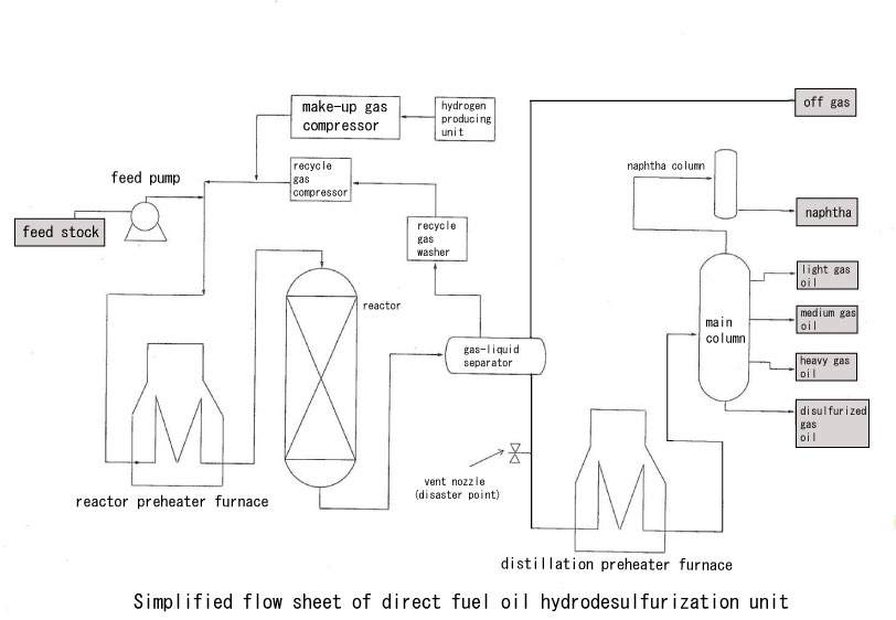

Fig2.Unit process flow

In September, 1996: the unit was completed. In the end of September: a trial run of the unit started. In December: the unit was shut down by an emergency shutdown system during the trial run. To investigate the cause, a high-pressure hose was connected to vent piping with the valve at the heating furnace inlet, and an investigation was performed by making nitrogen flow in. In January, 1997: preparatory work was carried out for a full-scale run. The temperature at the point of the fire was over 200 °C. On January 6th: the connected hose separated from the nozzle, and high-temperature oil spouted out. |
