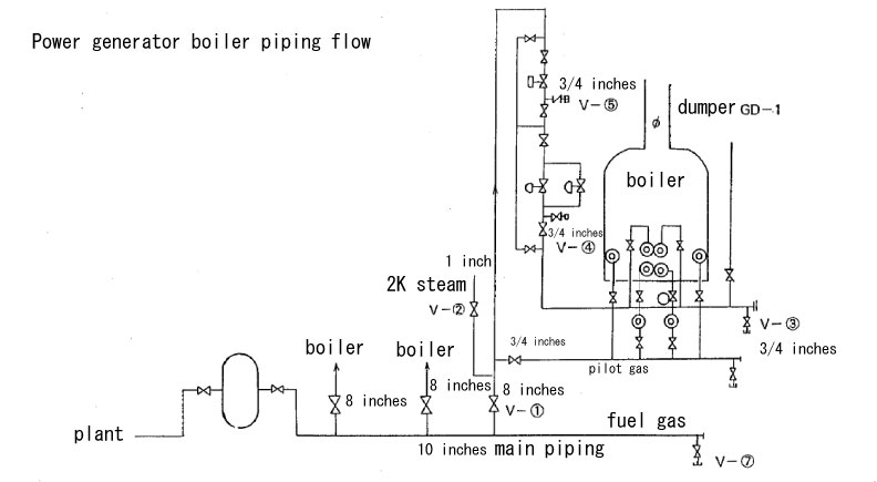

On start-up operation of a boiler for power generation, fuel gas was introduced into the fuel gas piping. An explosion occurred when the operator, due to a misunderstanding, put fuel gas into the furnace before it was ready for combustion. The accident was caused by a lack of knowledge on the handling of flammables, as well as an awareness of danger at the operator side. The education system that caused the lack of knowledge and misunderstanding of instructions should also be blamed. |
On start-up operation of a boiler for power generation, fuel gas was being introduced into the fuel gas piping after nitrogen-purging. An explosion occurred when an operator introduced fuel gas into the furnace by a misunderstanding about the operation procedure. |

09:50, on April 8th, 1977. Nitrogen purging in fuel gas piping started for the restarting operation of a boiler that had been stopped. 13:20. Fuel gas was introduced into a fuel gas header to replace nitrogen. 16:15. Fuel gas was introduced into branch piping to replace steam. The burner's main valve was opened slightly. 16:58. An explosion occurred. 17:21. The fire was extinguished. |
1. The valve for the burner was slightly opened due to a misunderstanding by one operator. As a result, fuel gas entered the furnace to form a combustible gas-air mixture. 2. Fuel gas accumulated in the furnace because the chimney effect was not available as the exhaust gas damper was closed. |

The operator misunderstood the operation procedure. He thought that the operation had been changed to purging operation for introducing fuel gas into the furnace to control the odor generated from introducing of fuel gas. Lack of education seems to have been a major factor causing such a misunderstanding. Although the actions were contrary to the basics of handling flammable gas, he did not notice that. |
