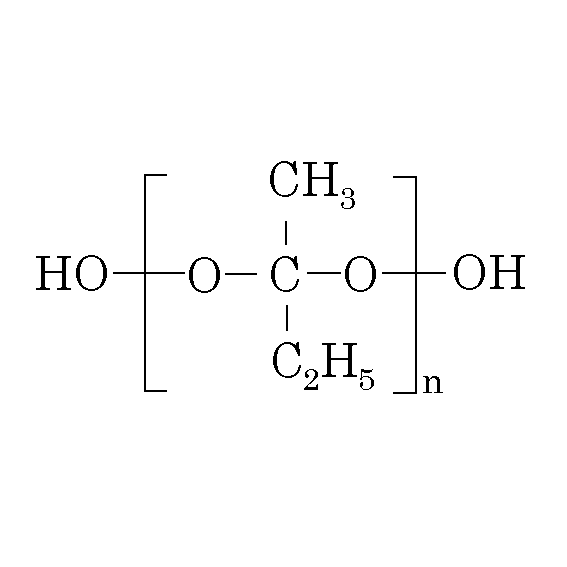

Methyl ethyl ketone peroxide, Fig2 |

Fig2.Chemical formula
