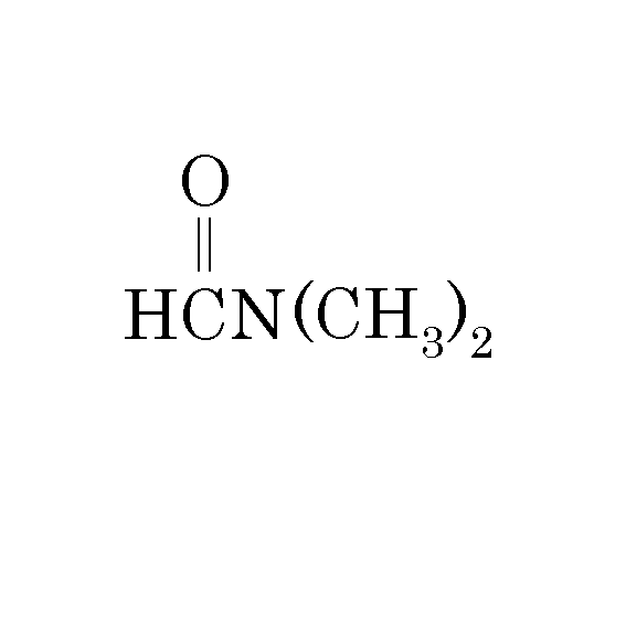

N,N'-dimethyl formamide, Fig2 |

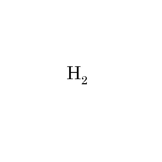

Hydrogen, Fig3 |

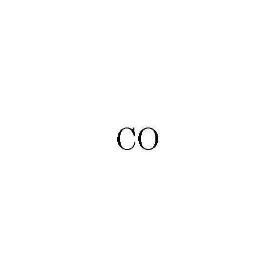

Carbon monoxide, Fig4 |

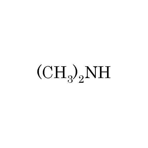

Dimethylamine, Fig5 |

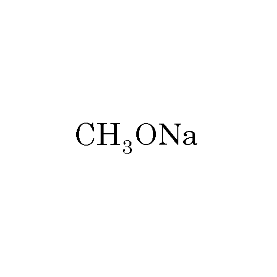

Sodium methylate, Fig6 |
