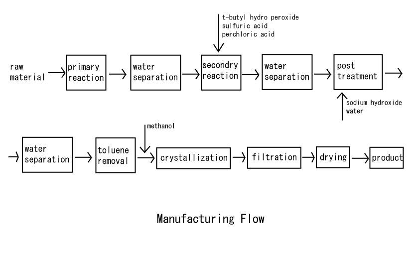

Fig2.Unit process flow

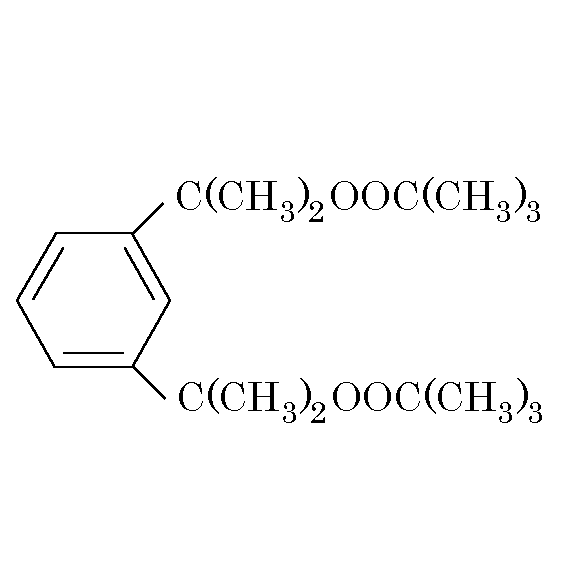

1,3- bis(t- butylperoxyisopropyl)benzene, Fig3 |

1. On January 21st, 1992. The afternoon shift finished the first order reaction and it progressed to the second order reaction. 2. Operation was handed over to the night shift during the second order reaction. 3. An operator of the night shift judged that the reaction temperature was low, and ran warm water at 70 °C into the reactor jacket. 4. 01:35 on January 22nd. The cracked gas spouted out from the manhole of the reactor and exploded on contact with ignition sources. |

Fig3.Chemical formula
