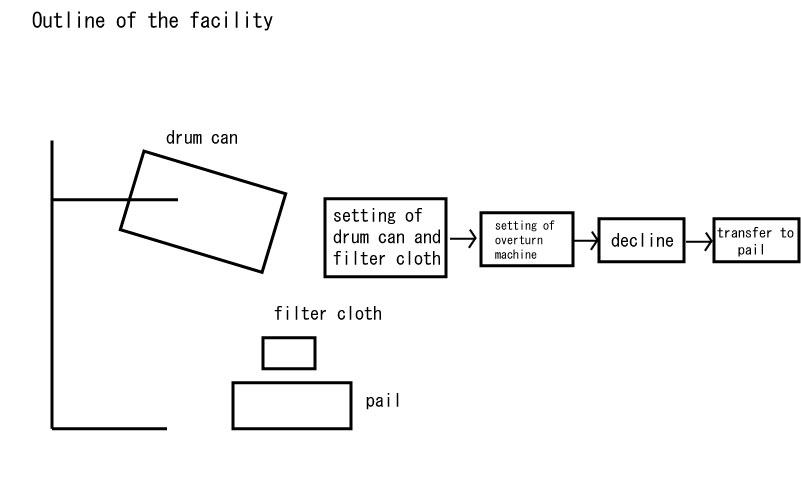

    | Incident | At a manufacturing plant for silicone resin, an explosion and a fire occurred during subdivision operations for silicone resin dissolved in an organic solvent. Subdivision was being done into a pail can through a cloth filter, while products (silicone 26%, n- heptane 60%, toluene 14%) in a 200 L drum can was being tilted by a drum tipping machine. At this time, it ignited around the cloth filter, which was made of polyester, the fire spread to the drum can through an air hole, and an explosion occurred in the vapor phase in the drum can. The fire spread due to a leak of a remaining liquid in the drum can. One worker died, and another worker received a serious injury. |

    | Process Flow | Fig2.Unit process flow |

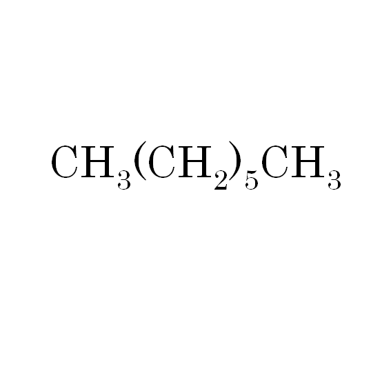

    | Substance | Heptane, Fig3 |

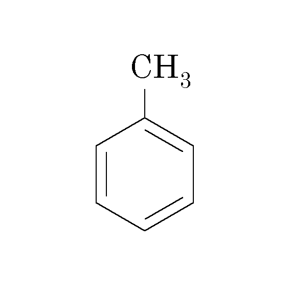

    | Toluene, Fig4 |
