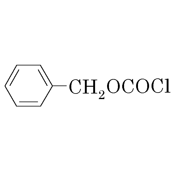

Benzyl chloroformate, Fig3 |

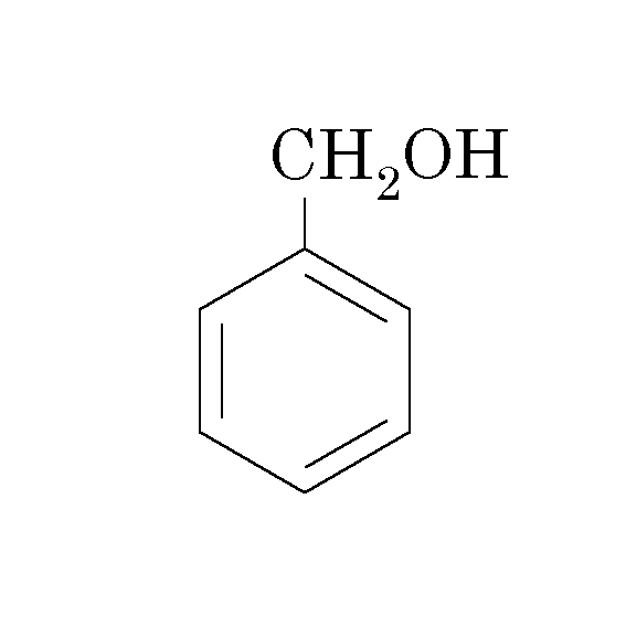

Benzyl alcohol, Fig4 |

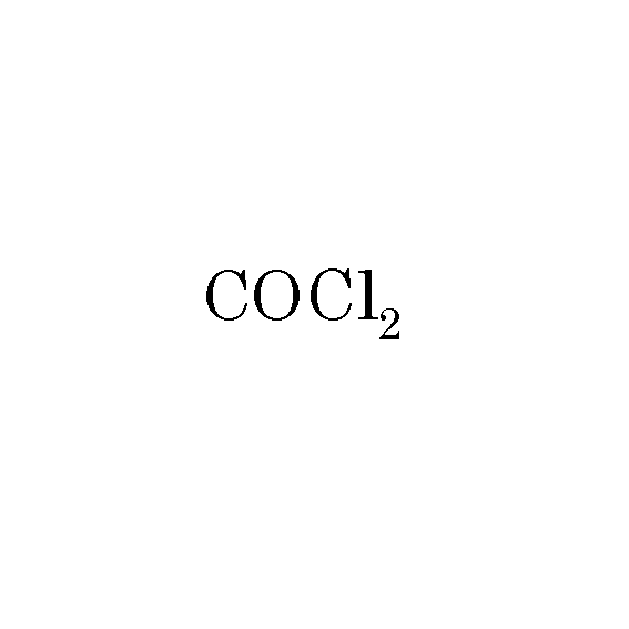

Phosgene, Fig5 |

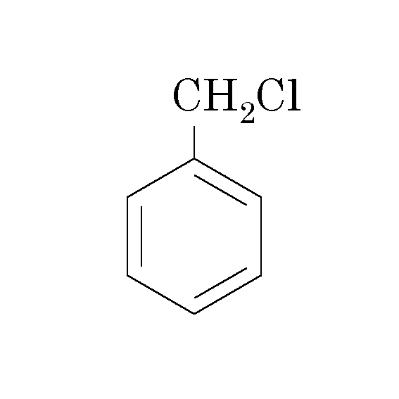

Benzyl chloride, Fig6 |

Fig4.Chemical formula
Fig5.Chemical formula
Fig6.Chemical formula
