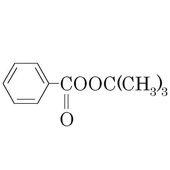

t-Butyl peroxybenzoate, Fig2 |

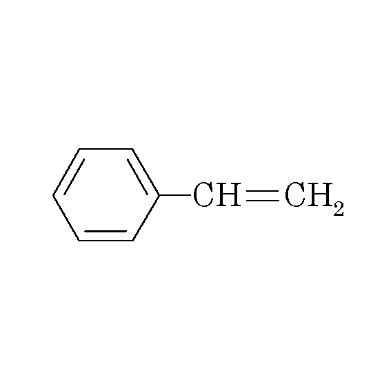

Styrene, Fig3 |
