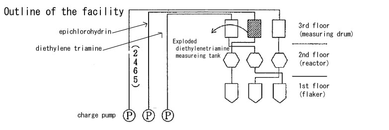

At a chemical factory, an explosion occurred at a measuring tank for chemicals. When an operator transferred chemicals contained in a drum to the measuring tank with a pump, the drum was placed and left near the pump. From the appearance of the drum, a third person guessed the name of substance and transferred it to an incorrect measuring tank with good intentions. Due to an incompatible reaction of two chemical materials, it exploded and a fire occurred. |
Diethylenetriamine was accidentally transferred to a measuring tank containing epichlorohydrin. Consequently, the pressure of the measuring tank rose due to a reaction, the tank ruptured, and a fire occurred. |

Fig2.Unit process flow

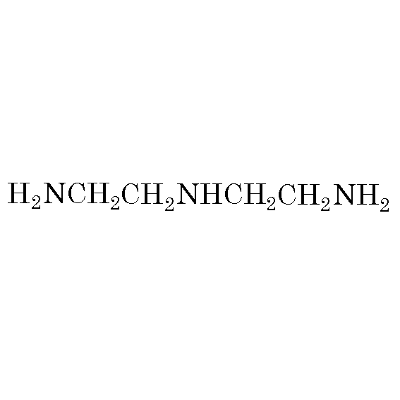

Diethylenetriamine, Fig3 |

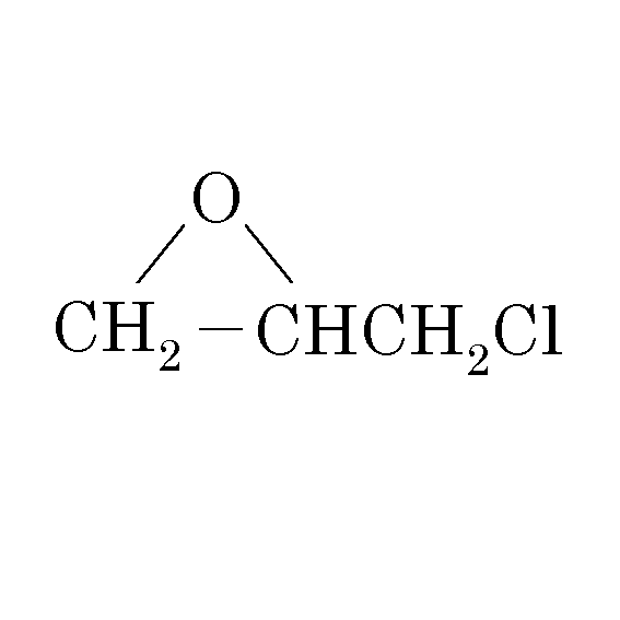

| Epichlorohydrin, Fig4 |

Past 10:40 on August 6th, 1998. An operator was carrying a drum in front of the feed pump from a drum can storage place. 10:50. Another operator started transfer work to a measuring tank to assist the operator voluntarily. The contents were judged to be epichlorohydrin from the color of the drum. A pump was attached to the drum and transfer started. The transfer was checked with a level meter in the control room. Transfer of the 2nd drum can started. 10:57. When the 1st empty drum can was carried to the empty drum storage place, the measuring tank exploded and a fire occurred. As the letter "diethylenetriamine" was written at the upper part of the drum can, the operator noticed the error after the explosion. 11:00. The public fire department was notified. 14 fire engines and 62 fire fighters turned out. The transfer pump was stopped. Valves were closed. The fire was not extinguished by initial fire extinguishing using a powder fire extinguisher. 11:08. The fire was extinguished. |
As diethylenetriamine was transferred to the measuring tank for epichlorohydrin, the tank swelled due to the reaction, and ruptured. The source of ignition is assumed to be electric sparks at the time the electric equipment was broken by the rupture. |

Fig3.Chemical formula
Fig4.Chemical formula
