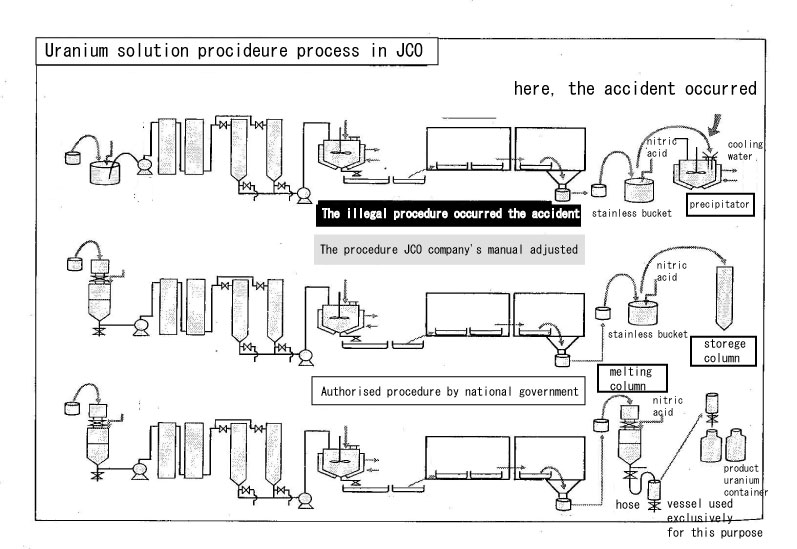

| Process Flow |
Fig2.Process flow

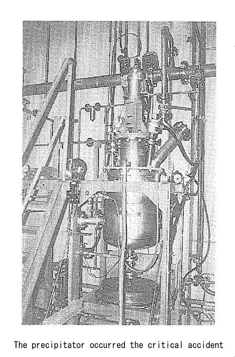

From mid-September to September 28th, 1999, highly concentrated uranium fuel was refined with many batches. On September 29th, the refined fuel was dissolved in nitric acid again by batch processing, and a nitric acid solution of uranyl nitrate was prepared. Then, some of the batch was mixed for homogenization. The uranyl nitrate solution of four batches was put into the vessel. (2.4 kg of uranium in a batch of 6.5 liters) On September 30th, three batches were also added to the vessel. About 10:35, a criticality state occurred, and three workers were exposed to radiation. 10:43, fire fighters received an emergency request from JCO. The fire fighters were aware of a radiation accident. After communications with Tokai village, Ibaragi Prefect., and Science and Technology Agency urgent countermeasures were taken. Countermeasures headquarters at each level were set up. Government countermeasures headquarters, led by the prime minister, was also set up. 15:00, the Tokai village headman directed inhabitants within a radius of 350 m to take refuge. 22:30, the Ibaragi Prefecture governor made a recommendation to stay indoors to inhabitants within a radius of 10 km. About 22:30, there were no indications that the critical state had been resolved, and the government field countermeasures headquarters decided to draw off water from the jacket of the vessel. 00:25 on October 1st, two person, the first suicide squads, who were selected from JCO employees, started draw-off work. 06:04, the 10th suicide squad succeeded in drawing off the water, and the critical state stopped. 08:39, injection of a boric acid solution into the vessel was completed, and the critical state ceased. Recommendations to inhabitants were reversed. |
In short, "the cause was only one that a uranyl nitrate solution including uranium above the critical mass was injected into the settling vessel, which had not been designed for criticality safety, and was originally intended for a different purpose." The settling vessel used for remelting and homogenization was the vessel in which the accident occurred, and use of the vessel was different from the original application. Homogenization work should be done in a container called a dissolution tower, but JCO thought the work was difficult, and decided to change the vessel without obtaining permission. On the day the accident occurred, the vessel was changed again to an unlicensed vessel. The whole process was submitted to Science and Technology Agency at that time, and all of the work had to be done using the facilities and methods approved. The following descriptions are shown in Fig3: Change of the mode of operation for remelting and homogenization. In the approved manual, remelting and homogenization are done using a dissolution tower, as shown in Fig3. However, homogenization work was transferred to a storage tower after dissolving in a stainless bucket, because using the dissolution tower was difficult for subdivision work in the final stage. The changed method still required hard work on distributing to the final subdivision container and too much time to mix for homogenization. The work was changed again. As using the storage tower was inconvenient, the settling vessel having a short and thick shape with a water jacket was used. As the surface area was small, neutrons had difficulty in leaving the vessel. Besides, the neutrons were reflected by the water in the jacket. The critical state, which did not occur in the tall storage tower, occurred in the settling vessel. In homogenization of the final process, one lot which included seven batches from upstream was handled, and the quantity of uranium in one batch was 2.4 kg. |

Fig4.Settling tank in which the critical accident was caused
