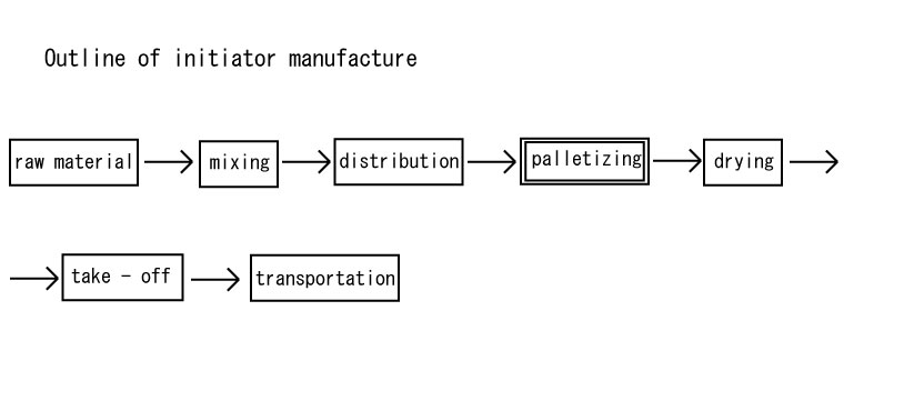

Fig2.Unit process flow

Although causes had not been clearly specified, the company in which the accident occurred presented the following two possibilities. 1. Diazodinitrophenol entered into a crack in a splitter plate fixed to the drier of a granulating machine with an adhesive agent. As a result, diazodinitrophenol ignited due to an impact and friction, burned, and detonated. 2. Iron rust contaminated in diazodinitrophenol in the granulating machine, and friction sensitivity increased. Therefore, diazodinitrophenol ignited in the granulating process, burned, and detonated. |
The following were done for preventive measures. 1. In terms of facilities. (1) Remodeling of the splitter plate in the lower part of the granulating machine. The machine was changed to an integral construction from an attached type so that it would be difficult for powder to get inside, and would be easy to inspect and clean. (2) The parts of the machine where iron rust might be generated and enter were changed to integral construction with rubber to prevent rust formation and contamination. (3) A prevention board against foreign materials and contamination was installed, so that foreign materials could not come into contact with explosives. 2. In terms of management. (1) Daily checks and turnaround checks were improved. (2) The importance of avoiding invasion of chemicals and foreign materials that might cause ignition and an explosion was reeducated. |
