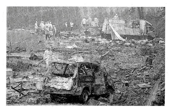

Inside the factory: 31 buildings (complete collapse of eight buildings, partial collapse of one building, damage to 22 buildings) and 24 cars. Outside the factory; 60 housing units and buildings (total loss by fire of one building and partial damage to 98 buildings), 18 cars. Damage ranged over a radius of about 850 m from the accident site. (Fire Fighting Station of Kagoshima City, May 31st) |
Concrete debris was scattered on an expressway and temporary speed control was carried out. |
Fig4.Field (Asahi Shimbun)
