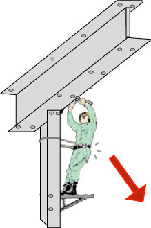

Overview On a construction site of 12-story condominium, when bolting work on the steel beam of the sixth floor was done during steel erection of the steel column, the ring of the safety belt (spring hook) which the worker used came off, and the worker fell about 17 meters. He was taken to the hospital, and he soon died. While the low consciousness of safety of the worker in the construction site was recognized, it became an opportunity to improve the way of safety education in an interested concern.
Incident When bolting work on the steel beam of the sixth floor was done during steel erection of the steel column, the ring of the safety belt (spring hook) which the worker used came off, and the worker fell to the ground, and he soon died.
Sequence From the morning, the work proceeded as planned, and workers hung the safety belt to the main rope and the gangway for going up and down on the steel beam of the sixth floor, and did a temporary tightening of the steel column of 3 knot part and steel column of 2 knot part with attached board and volt, in the condition that the steel beam was lifted by transportable crane. A worker A stood on the steel beam of the sixth floor, hung his safety belt to the stretched main rope, and carried out the temporary tightening work. Meanwhile, because there was no appropriate scaffold, a worker B passed his safety rope through the gangway of the steel column, put his weight on the rope of his safety belt in the condition of U-hanging, and carried out the work. Then, the worker B gave a shout, and he fell about 17 meters. He was taken to the hospital, and died of the blood loss by the thorax bruise after 2 hours.
Cause The direct cause of this case was that the worker B did not use the safety belt appropriately. As a different viewpoint, this case was caused by the management element of the management side such as the overly optimistic work planning of the original contractor and of the careless safety management in the site.
