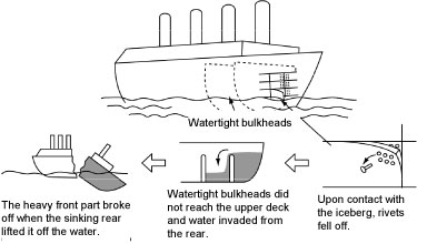

The luxury passenger liner Titanic, which was said to be unsinkable, on it's way from England to New York collided with an iceberg and sank. Titanic, despite of the multiple iceberg warnings it had received, she did not slow down. When the crewmembers discovered an iceberg, they steered the ship to evade it, but the vessel could not avoid the collision. A large quantity of seawater flooded into the ship due to damage to a major section of the hull and the ship sank. Insufficient number of lifeboats and the late call for help led to 1,517 deaths. |
The luxurious passenger liner Titanic collided with an iceberg and sank on the way from England to New York. When crews discovered an iceberg, they steered the ship to evade it, but the vessel collided, the hull eventually broke in half, and sank. Insufficent number of lifeboats and the late call for help were responsible for many of the 1,517 deaths. |

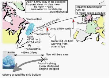

Titanic, which the entire world was keeping its eye on, was thought to be an unsinkable ship. On April 10, 1912, it left the British port of Southampton toward New York in the US on her maiden voyage with about 2,220 passengers and crew on board a month after its original scheduled departure. After starting on the voyage, Titanic received warnings that there was drift ice ahead from another ship twice, but she kept traveling at a high speed of 20.5 knots without slowing down, as the departure had been further delayed by an hour. At 23:40 on April 14, the crew discovered an iceberg 450m ahead and steered the ship and slowed down, but could not prevent the ship from grazing the iceberg. After colliding with the iceberg, they did not immediately ask for rescue via the wireless, and some passengers did not even know about the collision. Titanic sent help through the wireless for the first time at 0:14. The nearest ship, the California, was at 19 NM (nautical miles, about 35km) from Titanic, had already turned off the wireless at midnight. The Carpathia, which was 56 NM away, received it and headed its way to rescue. Titanic launched a signal flare at 0:44, but the California that was traveling nearby did not take it as a rescue signal and left without stopping. Titanic sank at 2:20am. The Carpathia finally arrived at 4:10, two hours after the ship had submerged. |
The direct cause of this accident was a collision with an iceberg. The hull consisted of a large number of compartments, an unusually of building a ship at the time but the collision damaged the ship by a tear in the side and many compartments were destroyed upon contact. The ship then could not depend on the momentum by other compartments that would have allowed her to correct its posture. In addition, there were causes that Titanic ignored warnings of an iceberg twice, that the amount of drift ice was increased because the departure was delayed by one month, and crew did not use binoculars for monitoring even in the poor visibility at night. Reasons for the large number of victims were insufficient the number of life-boats, the crew not sending a rescue signal immediately after the collision from the overconfidence in the hull with many compartments, and a nearby ship the California turning off their wireless and not knowing the meaning of the lamp signal. |
