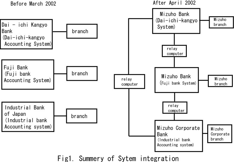

The serious banking system problems disrupted the new banks' operations following the April 1 launch of Mizuho Bank and Mizuho Corporate Bank into which Dai-ichi Kangyo Bank Ltd., Fuji Bank Ltd. and Industrial Bank of Japan Ltd. had been consolidated under the management of Mizuho Holding in Tokyo. The Mizuho Bank's important first day in business was tarnished by the ATM (automatic teller machine) transaction errors and delayed automatic debits for utility and credit card bills. The biggest banking system failure in history caused chaos, from which the recovery took more than one month until the bank's operations went completely back to normal. A long period of failed discussion among the three banks about whose computer systems would survive the merger left insufficient time for the implementation period of a relay system to bridge the banking systems. The bank group went ahead with integration and the operation of the unified banking system, despite the testing period of the unified operation was not long enough for the large-scale operation. |
As part of the finance-industry reorganization, Dai-ichi Kangyo Bank Ltd., Fuji Bank Ltd. and Industrial Bank of Japan Ltd. were consolidated into Mizuho Bank Ltd. and Mizuho Corporate Bank Ltd. under the management of Mizuho Holding in Tokyo. The new Mizuho Bank's first day in business (April 1, 2002) was tarnished by the ATM (automatic teller machine) transaction errors in which debits were made from accounts although customers did not receive cash from the machine, as well as unprocessed scheduled automatic debits for utility and credit card bills. The banking system failed to process 105,000 automatic debits scheduled for April 1. Delayed debits backlogged, and the number of delayed debits reached 2.5 million by the end of April 5. An additional 30,000 double debits were found between April 1 and April 5. The biggest banking system failure in history caused chaos, from which the recovery took more than one month until the bank's operations went completely back to normal. |
The course of this case is summerized in list1. |
(1) Technical factor (direct cause) a. ATM transaction errors The Mizuho Bank's primary banking system (previous Dai-ichi Kangyo Bank system using the Fujitsu mainframe) was not modified properly. The program added to handle logical connection between the primary system and the relay systems had a bug that caused a specific problem in certain circumstances. It was an oversight during the program development. b. Delayed automatic debits - Invalid information in the transaction request data. - A bug in the program developed for processing debits transaction for bridged banking network. The problems surfaced only under certain conditions such as "data of different types or categories are combined in a certain manner during processing" when "data overflow or excessive transactions accumulated in the data storage area for the relay computer". The first bug fix failed to correct the programming errors and caused the recurrence of the online banking system failure on April 8. c. Insufficient testing period of the unified operation and load tests. Program development always accompany bugs. Thorough operational testing and debugging were critical for the unified system before bringing them on-line. Testing should have simulated the real large scale banking operation and various complicated situations. (2) Corporative factor (principal cause) a. Delayed decision on the system integration scheme (problems during planning) The merger lacked the dominating party that can effectively take charge, and the three banks simply could not agree on whose computer systems would survive the merger. The system integration scheme changed a few times until the three banks reached a settlement. The three banks should have proposed the most adequate scheme after assessing the requirements on the unified banking system and evaluating the existing banking systems of the three banks. Instead of determining the system that would survive the merger, the three banks knocked out a compromise, involving relay systems to simply bridge the existing systems of the three banks. This temporizing scheme involving relay systems was not inadequate itself; however, delay in decision making resulted in insufficient period for testing and systems integration. The scheme lacked the architecture concept. When making changes in banking systems such as integration, it is best to choose the time of year when processing volume is smaller. April 1 has been usually the busiest day of the year for the three banks, and scheduling system changes on such a day was not advisable. In addition, the three banks that merged into Mizuho were too fixated on their schedule to perfect the systems integration, which compounded the problem. b. Delay in preparations for system integration Problematic management organization for the integration project. The Mizuho Holding management committee did not receive accurate status reports in a timely manner, while there had been evident delays in preparation for the scheduled system integration. The three banks independently performed preparation towards the scheduled system integration without reporting status to each other or to the holding company. The CEOs (chief executive officer) of the three banks knew of the delay after receiving several reports in 2001 from their banking system divisions. The CEOs simply instructed their banking system divisions to make up for the delay without looking into details. c. The bridging systems were not tested thoroughly for their performance and processing loads before bringing them on-line. d. The Mizuho Holding management committee went ahead with integration and the operation of the unified banking system, despite the delay in preparation and risks of system failures during the real banking operation. |

Figure1.Banking System Integration Scheme
