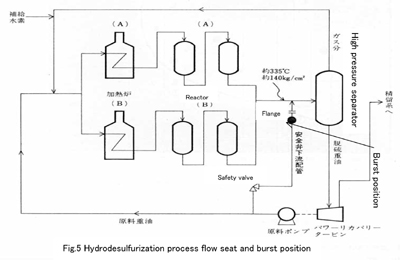

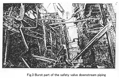

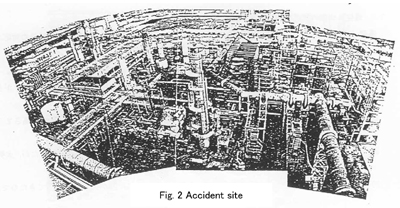

The process fluid began to leak from the downstream piping of the safety valve of the carbon steel by-pass piping in the residue hydrodesulfurization unit, during unit operation on March 31st, 1982. As a result, the piping exploded, and a fire occurred. This process unit had been operating for 12 years prior to the explosion. This by-pass piping was located downstream of the safety valve, and it was connected to the main stainless steel piping from the reactor exit to the high-pressure separator. The main stainless steel piping was operated at a temperature of 335degree C, a total pressure of 140kgf/cm^2, and a hydrogen partial pressure 120kgf/cm^2. However, the process fluid did not flow to the piping of the safety valve downstream during normal operation, and therefore the internal temperature designed for the by-pass piping was low. A survey of the damaged parts showed that the piping had been damaged by an intense hydrogen attack. The strength of the part of the piping suffering from the hydrogen attack was decreased, and it was thought that this decrease in strength caused the piping to explode. Figure 2, Figure 3, and Figure 4 show the appearance of the crash site. Five operators died in this accident, and three people were seriously injured, and the unit suffered enormous damage. |

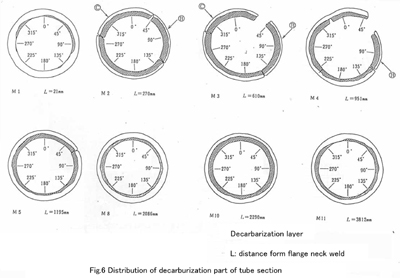

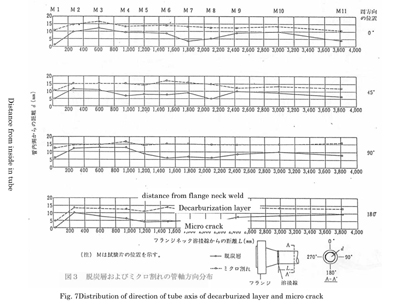

The process fluid, including high temperature high pressure hydrogen, flows to the main piping from the reactor exit to the separator. Stainless steels (20B, SUS321) were used for this main piping. Branch piping 1,300mm in length of same material (6B, SUS321) had been installed horizontally in the main piping. The damaged carbon steel by-pass piping (6B, STPT38) of the safety valve downstream was connected with the stainless steel branch piping (6B, SUS321) by a flanged connection (Refer to Figure 5). During regular operation, the fluid does not flow through the pipe. Therefore, the system had been designed based on the assumption that the temperature of the carbon steel by-pass piping would not rise. The burst happened in the direction of the tube axis from a distance of 36mm from the flange welding line to a distance of about 1.2m. As a result of studies including microscopic examination, it was concluded that the hydrogen attack had occurred on the inner side of the piping, and that the decarburization had occurred in the flange weld of the carbon steel piping resulting in micro intercrystalline cracks in a part of the piping about 5.5 m in length. Micro cracks extended throughout the whole area of the tube section in the vicinity of the part of the piping that had burst as shown in Figure 6, and it is thought that the first leakage had occurred through a micro crack. (Refer to Figure 7). Judging from the Nelson chart (API 941) that shows the boundary of safety from the hydrogen attack , the damaged part was presumed to have been kept at a temperature of 230degree C or more for a long time. However, although the interaction between the carbon steel branch piping and the stainless steel piping of the high temperature driving condition (335degree C and hydrogen partial pressure 120kgf/cm^2) was examined, the temperature rise mechanism of this carbon steel piping was not determined conclusively. The mechanism of the heat-pipe phenomenon was presumed as a strong inference of the possibility. That is, when the steam was added to promote the hydrodesulfurization reaction, it condensed in the carbon steel piping of the line in the part where the fluid did not flow during operation. The condensed water flowed backward to the main piping, causing the inflow of the high temperature fluid to the damaged part, which raised the temperature of the carbon steel piping. |

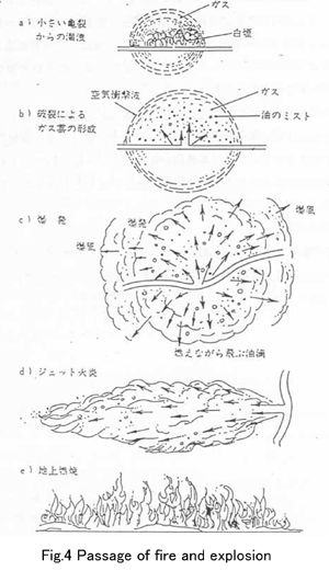

After having detected the pressure abnormality, eight people who were in the operation room gathered to the leakage site for the purpose of the site confirmation. The explosion occurred just 4-5 minutes after the leakage was discovered, resulting in extensive damage, five deaths, and three serious injuries. |
It was thought that the line stopping carbon steel branch piping was designed to be maintained at a low temperature. However, the piping actually reached the high temperature of 230degree C or more because of the heat-pipe phenomenon caused by the condensation of the steam added to the reactive system. The carbon steel piping received the hydrogen attack causing the mechanical strength of piping to decrease, and the leakage of the process fluid happened after twelve years of operation. |

Fig_2.Accident site.
Fig_3.Burst part of the safety valve downstream piping.
Fig_4.Passage of a fire and explosion.
Fig_5.Hydrodesulfurization precess flow seat and burst position.
Fig_6.Distribution of decarburization part of tube section.
Fig_7.Distribution of direction of tube axis of decarburized layer and micro crack.
