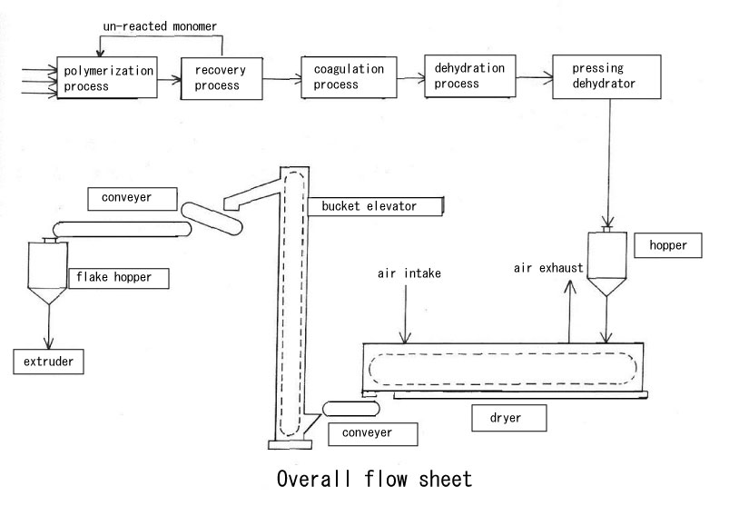

Black smoke rose from the drying room and the bucket elevator on drying ABS resin. There was an increased quantity of powder generated after the drier was remodeled two months before, and powder concentration increased due to the replacement of generated powder to the bucket elevator inlet. Nevertheless, no measure had been taken. As powder is potentially explosive, the facilities should be modified to reduce powder generation. |
As ABS resin is wet powder after reaction, it has to be dried to reduce its moisture to below 1% before being pelletized by an extruder. The dryer was exchanged to another model for energy saving. About two months after, black smoke rose during usual operation from the drying room and the bucket elevator. |

Process Flow |
Fig2.Unit process flow

In April, 1984. The drier was changed to a squeezing dehydrator. The amount of resin powder increased as a result. The powder was returned to a bucket elevator. 19:15 on June 30th. Fire alarm sounded during operation. Black smoke rose from the drying room and the conveyor. 20:30. Fire was extinguished by spraying water. |
With static electricity generated in the bucket elevator for carrying dried and dehydrated ABS resin to the extruder, the ABS resin powder was ignited. |
Extinguished by water |
1 The dehydration molding machine was changed to one that generated less powder. 2. Instead of the bucket elevator, a gas conveying system with nitrogen was installed. 3. Remote operation system was introduced to do emergency shutdown and fire fighting quickly in case of similar accidents. |
