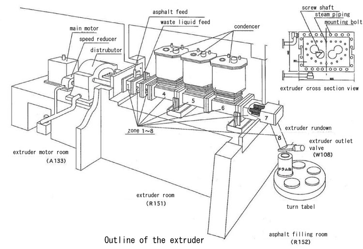

The Cause of the fire. During natural cooling of the treated solid, as a result of heat accumulating during a slow chemical reaction in a drum, the temperature of the treated solid rose locally. It is assumed that the reaction of nitrate/nitrite salt with asphalt progressed rapidly. The cause of the slow reaction is that the start temperature for natural cooling was high. The temperature rose because the amount of asphalt supplied to the extruder was reduced by twenty percent. This rise is characteristic of an extruder that kneads asphalt and wastes. The appearance of the extruder is shown in Fig2. Radioactive wastes were supplied with nitrate/nitrite salt. Cause of explosion. As fire extinguishing with water was carried out for a short time, although the fire appeared to have been extinguished, the insides of the drums were smoldering. Therefore, reactions between an bituminized solid and nitrate progressed, and a flammable substance was emitted from the asphalt. As ventilation was stopped by the fire, the filling room and an adjoining room were filled with flammable material. A combustible gas-air mixture was formed. And it is assumed that the high-temperature bituminized solid ignited again. |

Fig2.Extruder figure
